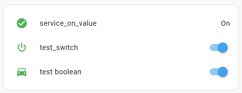

  2. Select my_theme in settings:
  3. Then you will get your customized look:

Ok, sorry, you are right. It does work for switch.xxxxx , I was checking light.xxxxx

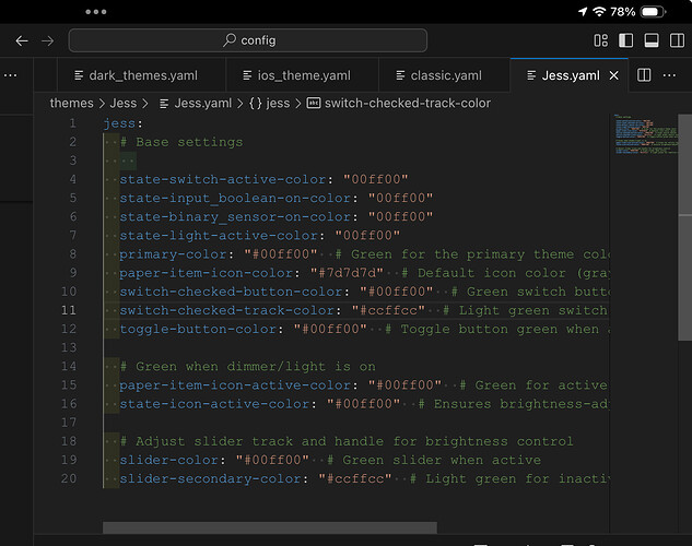

Here is my theme, what am I doing wrong?

here is my current theme as text. I can’t seem to copy from the HA editor when using an iPad, but from Mac it works much easier!
theme is named 'Jess;
jess:
Base settings
primary-color: “#00ff00” # Green for the primary theme color
state-switch-active-color: “00ff00”
state-input_boolean-on-color: “00ff00”
state-binary_sensor-on-color: “00ff00”
state-light-active-color: “00ff00”
state-icon-active-color: “#00ff00” # Ensures brightness-adjusted lights also turn green
paper-item-icon-color: “#7d7d7d” # Default icon color (gray)
paper-item-icon-active-color: “#00ff00” # Green for active lights
switch-checked-button-color: “#00ff00” # Green switch button
switch-checked-track-color: “#ccffcc” # Light green switch track
toggle-button-color: “#00ff00” # Toggle button green when active
slider-color: “#00ff00” # Green slider when active
slider-secondary-color: “#ccffcc” # Light green for inactive slider track
