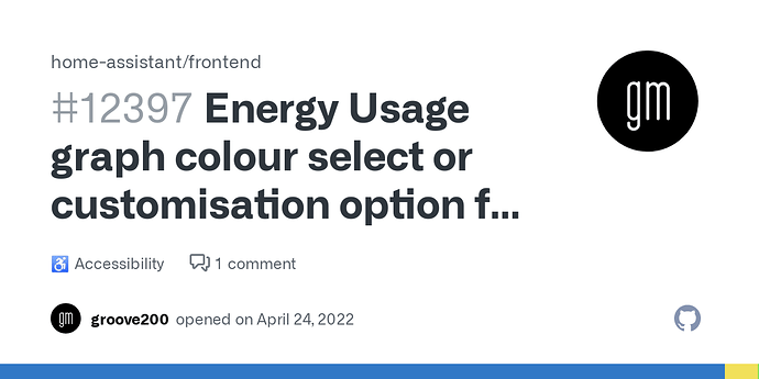

A feature request has been posted on the github frontend repository.
I am postin this link on all the post I can find here.
Make sure to upvote :slight_smile:

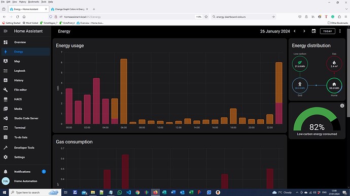

The video helped me work it out and I now have custom energy graph colours working.

You can do now by switching the order in the dashboard settings
