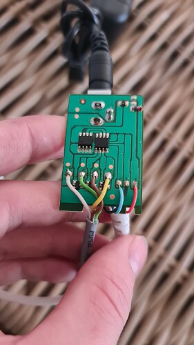

This is the current led strip controller
I’m not sure which one to get? Is it the rgbw controller from Gledopto? It has 5 pins, while there are only 4 wires coming from the led strip. There is a 4 pin led controller but that is WW V+ CW V-

I guess it’s just a normal led strip. Is it possible to connect it to a rgb cct controller for example and just hook the 4 wires to it? I’m not sure which is v+ and rgb because the colors are mixed up… I see on the current led strip controller v+ it should be the yellow wire.
Since it’s LEDs, if it’s not connected in the correct it won’t light up.
But if you just find a ground, then you can quite easily find the VCC.
The other three is just a matter of trial and error. Make it green, move the cable between the pins until it’s green light.
Then do the same for the next and red color.
