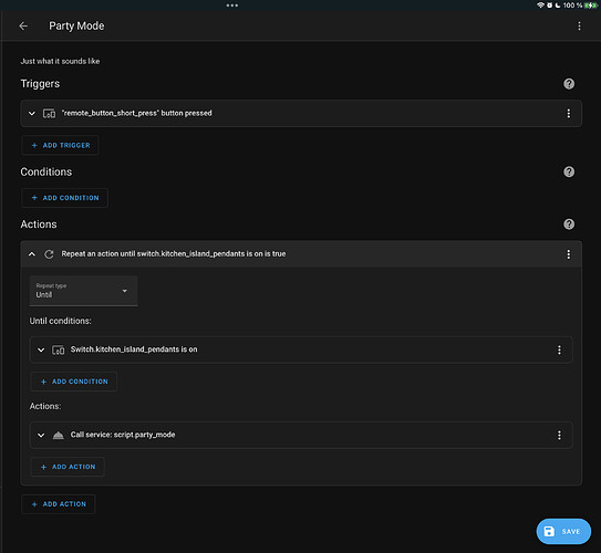

I looked, but the issue with the forum is that the amount of data is vast and my terminology might not be great I will continue to look and close my own if I find something else! See below with my Script and Automation:
Hey thanks for showing it in the UI. I get what I did now - I’m sort of thinking backwards - I called the service and then told something to loop, but really nothing. I needed to create the loop and then embed the service call inside it. I’m thinking English instead of math
