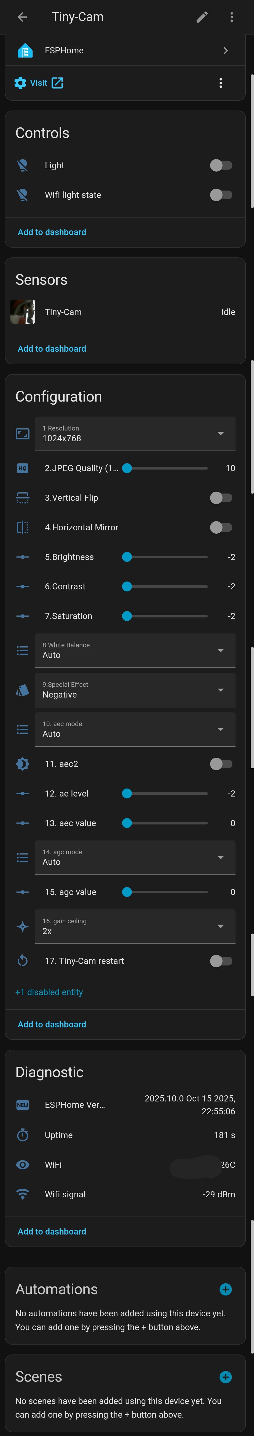

I’d also like this. My camera does not show all of this API configuration on its entity card.
EDIT:
Managed to do that. The options apears directly on entity’s page and they can be used on any card. I still need to implement other options, but you can get the idea. just put this on esphome YAML:
globals:
  - id: brightness_atual
    type: int
    restore_value: yes
    initial_value: "0"
  - id: contraste_atual
    type: int
    initial_value: "0"
    restore_value: yes
  - id: saturacao_atual
    type: int
    initial_value: "0"
    restore_value: yes
  - id: vflip
    type: bool
    restore_value: yes
    initial_value: "true"
  - id: hmirror
    type: bool
    restore_value: yes
    initial_value: "false"
  - id: resolucao_atual
    type: int
    restore_value: yes
    initial_value: '4'
esphome:
  on_boot:
    - priority: 600
      then:
        - lambda: |-
            using FrameSize_t = esphome::esp32_camera::ESP32CameraFrameSize;
            id(espcam).set_vertical_flip(id(vflip));
            id(espcam).set_horizontal_mirror(id(hmirror));
            delay(50);
            id(espcam).set_brightness(id(brightness_atual));
            id(espcam).set_contrast(id(contraste_atual));
            id(espcam).set_saturation(id(saturacao_atual));
            id(espcam).set_frame_size((FrameSize_t) id(resolucao_atual));
esp32_camera:
  external_clock:
    pin: GPIO0
    frequency: 10MHz
  i2c_pins:
    sda: GPIO26
    scl: GPIO27
  data_pins: [GPIO5, GPIO18, GPIO19, GPIO21, GPIO36, GPIO39, GPIO34, GPIO35]
  # the order of the data_pins is significant, don't mix up the order
  vsync_pin: GPIO25
  href_pin: GPIO23
  pixel_clock_pin: GPIO22
  power_down_pin: GPIO32
  ## Image Config
  resolution: "1024x768"
  max_framerate: 30fps
  idle_framerate: 0.2fps
  jpeg_quality: 10
  brightness: 2
  contrast: 1
  saturation: 0
  special_effect: none
  # exposure settings
  aec_mode: auto
  aec2: false
  ae_level: 0
  aec_value: 300
  # gain settings
  agc_mode: auto
  agc_gain_ceiling: 2x
  agc_value: 0
  # white balance setting
  wb_mode: auto
  vertical_flip: true
  horizontal_mirror: false
output:
  - platform: ledc
    pin: GPIO4
    channel: 2      # channel 1 is used for esp32_camera
  # red status light
  - platform: gpio
    pin:
      number: GPIO33
      inverted: True
light:
  - platform: monochromatic
    output: led
  - platform: binary
    output: gpio_33
binary_sensor:
  - platform: status
esp32_camera_web_server:
  - port: 8080
    mode: stream
  - port: 8081
    mode: snapshot
# AJUSTES DA CÂMERA
#          if (("aec_mode" == name) && (value >= 0U) && (value <= 1U)) { id(espcam).set_aec_mode((esphome::esp32_camera::ESP32GainControlMode)value); state_return = true; }
#          if (("aec2" == name) && (value >= 0U) && (value <= 1U)) { id(espcam).set_aec2(value); state_return = true; }
#          if (("ae_level" == name) && (value >= -2) && (value <= 2)) { id(espcam).set_ae_level(value); state_return = true; }
#          if (("aec_value" == name) && (value >= 0U) && (value <= 1200U)) { id(espcam).set_aec_value(value); state_return = true; }
#          if (("agc_mode" == name) && (value >= 0U) && (value <= 1U)) { id(espcam).set_agc_mode((esphome::esp32_camera::ESP32GainControlMode)value); state_return = true; }
#          if (("agc_value" == name) && (value >= 0U) && (value <= 30U)) { id(espcam).set_agc_value(value); state_return = true; }
#          if (("agc_gain_ceiling" == name) && (value >= 0U) && (value <= 6U)) { id(espcam).set_agc_gain_ceiling((esphome::esp32_camera::ESP32AgcGainCeiling)value); state_return = true; }
#          if (("test_pattern" == name) && (value >= 0U) && (value <= 1U)) { id(espcam).set_test_pattern(value); state_return = true; }
number:
  - platform: template
    entity_category: config
    optimistic: true
    min_value: -2.0
    max_value: 2.0
    step: 1.0
    set_action:
      lambda: |-
        id(espcam).set_brightness(x);
        id(brightness_atual) = x;
        id(espcam).update_camera_parameters();
    optimistic: true
    min_value: -2.0
    max_value: 2.0
    step: 1.0
    set_action:
      lambda: |-
        id(espcam).set_contrast(x);
        id(contraste_atual) = x;
    optimistic: true
    min_value: -2.0
    max_value: 2.0
    step: 1.0
    set_action:
      lambda: |-
        id(espcam).set_saturation(x);
        id(saturacao_atual) = x;
    name: "JPEG Quality (10=high)"
    icon: mdi:quality-high
    # Range da Qualidade (de 10 a 63) 10 = Máx)
    min_value: 10.0
    max_value: 63.0
    step: 1.0 # Passos de 1 em 1
    set_action:
      lambda: |-
        id(espcam).set_jpeg_quality(id(jpeg_quality).state);
select:
    optimistic: true
    options:
      - "Auto"
      - "Sunny"
      - "Cloudy"
      - "Office"
      - "Home"
    set_action:
      - lambda: |-
          using namespace esphome::esp32_camera;
          if (x == "Auto") {
            id(espcam).set_wb_mode(ESP32_WB_MODE_AUTO);
          } else if (x == "Sunny") {
            id(espcam).set_wb_mode(ESP32_WB_MODE_SUNNY);
          } else if (x == "Cloudy") {
            id(espcam).set_wb_mode(ESP32_WB_MODE_CLOUDY);
          } else if (x == "Office") {
            id(espcam).set_wb_mode(ESP32_WB_MODE_OFFICE);
          } else if (x == "Home") {
            id(espcam).set_wb_mode(ESP32_WB_MODE_HOME);
    icon: mdi:palette-swatch
    optimistic: true
    options:
      - Negative
      - grayscale
      - red_tint
      - green_tint
      - blue_tint
      - sepia
      - None
    # 3. Código Lambda para Ação
    set_action:
      lambda: |-
        if (x == "None") {
          id(espcam).set_special_effect(ESP32_SPECIAL_EFFECT_NONE);
        } else if (x == "Negative") {
          id(espcam).set_special_effect(ESP32_SPECIAL_EFFECT_NEGATIVE);
        } else if (x == "grayscale") {
          id(espcam).set_special_effect(ESP32_SPECIAL_EFFECT_GRAYSCALE);
        } else if (x == "red_tint") {
          id(espcam).set_special_effect(ESP32_SPECIAL_EFFECT_RED_TINT);
        } else if (x == "green_tint") {
          id(espcam).set_special_effect(ESP32_SPECIAL_EFFECT_GREEN_TINT);
        } else if (x == "blue_tint") {
          id(espcam).set_special_effect(ESP32_SPECIAL_EFFECT_BLUE_TINT);
        } else if (x == "sepia") {
          id(espcam).set_special_effect(ESP32_SPECIAL_EFFECT_SEPIA);
    icon: mdi:aspect-ratio
    optimistic: true
    options:
      - 1024x768
      - 800x600 # SVGA
      - 640x480 # VGA (Comum para a maioria)
      - 320x240 # QVGA (Boa para streaming rápido)
      # Adicione outras resoluções suportadas pelo seu modelo (ex: 1024x768, 1600x1200, 1280x1024)
    set_action:
      lambda: |-
        int resolucao = 4;
        if (x == "1024x768") {
          resolucao = 6;
        } else if (x == "800x600") {
          resolucao = 5;
        } else if (x == "640x480") {
          resolucao = 4;
        } else if (x == "320x240") {
          resolucao = 3;
        } else {
          // Fallback para 640x480 (VGA) se a opção for inválida
          resolucao = 4;
        id(espcam).set_frame_size((FrameSize_t) resolucao);
        id(resolucao_atual) = resolucao;
switch:
  - platform: restart

Last Update: updated YAML code with full control.
Still cant call update_parameters with set vflip or hmirror.
Hi!, I am trying to get the configuration o the entity page, when you say put this on esphome YAML, do you mean the camera YAML?
Thanks!
Sorry about the delay.
Yes. It’s the camera esphome YAML.
I’ll update with my full code.
I just can´t get to work the change hmirror and vflip, properly, the camera gets stuck on startup. But it’s managable by changing the option and change another after that, like brightness.
Alex, thanks a lot for taking the time to answer and loading you full config, It helped me a lot to adapt mine. and is working now!!
I’ll try to implement the other properties and load mi YAML.
once again thanks Alex.
I’ve managed to take in all the parameter, and might take a while to try them all.,so far I’m having the same issue as you with v_flip not working and h_mirror only working when updated by other entity (which has id(espcam).update_camera_parameters(); )
looks like this:
long story short, here’s the full code:

    icon: mdi:brightness-4
    optimistic: true
#Not sure if it works
    turn_on_action:
      lambda: |-
        id(espcam).set_aec2(true);
    turn_off_action:
      lambda: |-
        id(espcam).set_aec2(false);
I wonder if I regoister a service to change these parameters and call it from HA will solve the problem. I will try it as soon as I can.
