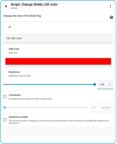

I recently purchased a Shelly Plus Plug S and needed to change the LED color.
I found @Minizag code and adapted it to the latest Home Assistant version available at the moment (2025.12.3).
New features:
  • RGB color selector
  • Brightness input
  • Countdown (OPTIONAL): Turns device off after a certain time
  • Sets RGB boundaries and corrected the variable descriptions according to the Shelly API.
Add to configuration.yaml:
Create a new Script:
IMPORTANT: Script Entity ID should be: script.change_shelly_led_color
Go to the three dots () menu → Configure as YAML
alias: Change Shelly LED color

Run the script from an automation:
  1. Create a new automation.
  2. Add an action → Script → select the previously created script “Change Shelly LED color.”
  3. Select the Shelly parameters as you wish from the UI :tada:
Regards!
