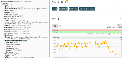

Here is what MQTT is passing (from MQTT Explorer).

Seems to me that HA is picking up the temperature to 1 decimal place, but storing and reporting it using whole numbers.

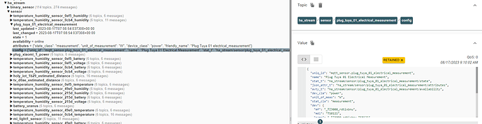

As you seem unaware, you surely didn’t define the MQTT sensor manually in HA, so it comes from a discovery topic.
That topic is likely named homeassistant(ha_stream for me)/sensor/<name_of_sensor>/config
Please post its content.

Is this what you are looking for?
See above :wink:
Aaah. I see it now. Thank you. But how can / where do I change it?
That’s done in whatever’s creating that discovery information. I.e. the custom integration.
