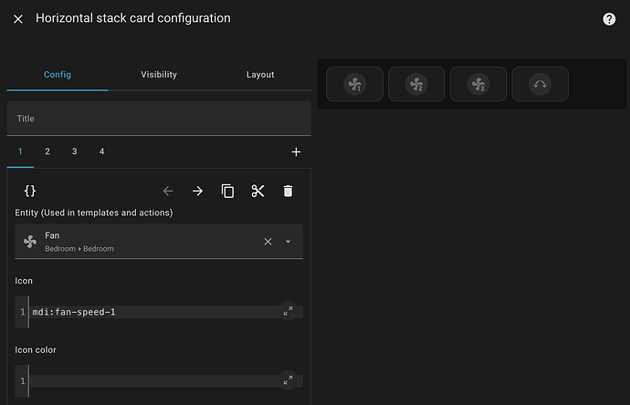

In order to control my ceiling fan’s variable speeds, I created a Horizontal stack on my dashboard.
Is there a way I can configure the Horizontal Stack to highlight the last pressed speed button with a different color, so that I can visibly see which speed is currently running?

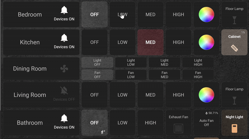

I have the following style code setup on my dashboard but I use it with the grid card in horizontal cards withbutton_card_templates and the Custom Button Card. I use the template so I only have to right it once and then just reference the template for each row.
I change the button background (the color of the light) and then the font color and weight when active or inactive. (If you post your code I could probably help more.)

Here’s mine…
ezgif-79ba717ed27e5b
