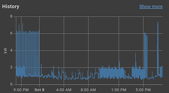

I also assume when you say you want the values separate, you are talking about in history graphs?
and not this
If so, just create a template sensor that duplicates your original sensor without a state_class.
