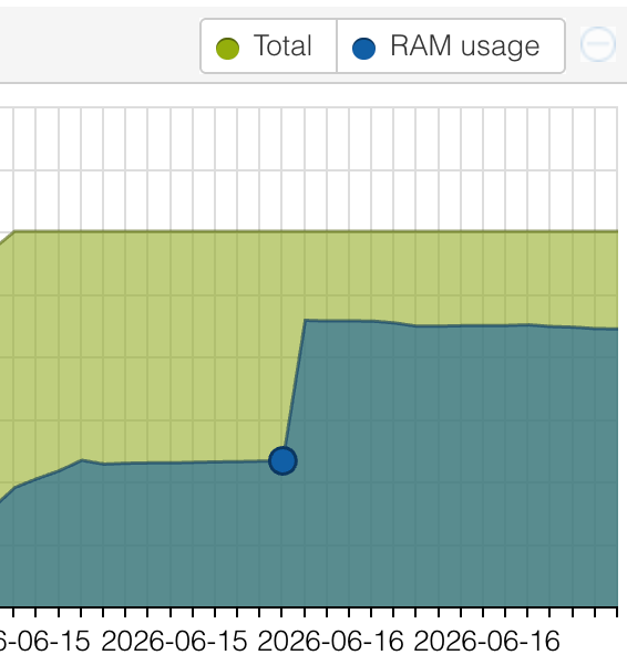

I moved the scheduled backup to 2AM while tracking memory on Proxmox. Memory went from 4.65G at 2AM to 9.15G at 2:30AM. With these changes my frontend didn't crash, but the memory didn't settle back down. I'm going to eliminate the Nabu Casa backup tonight to see if that is leaking memory.

Are you running snapshot backups in proxmox?
If so, this locks up the db in HA, and your write ahead file (.wa1) might get bloated and will cause backups to fail - I have experienced this in my own system.
My solution was to disable short cycle snapshot for HA VM, and only do a weekly Snapshot. After some days, the .wa1 file is sorted and written to the main db and backups will work fine again.
