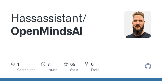

Checkout the latest version for free GPT4 Access.

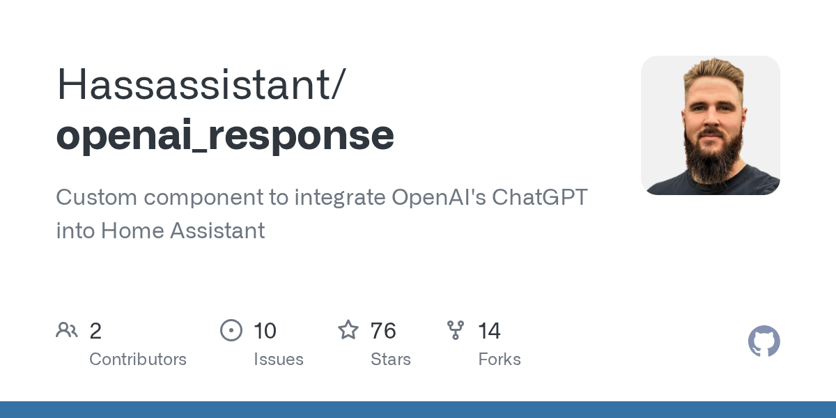

Just want to advertise that there’s some improvements done. There’s PR that brings service call and support for models gpt-3.5-turbo and gpt-4.
See Multiple enhancements by Olen Ā· Pull Request #6 Ā· Hassassistant/openai_response Ā· GitHub
and openai_response/custom_components/openai_response at gpt-3.5-turbo Ā· Olen/openai_response Ā· GitHub
