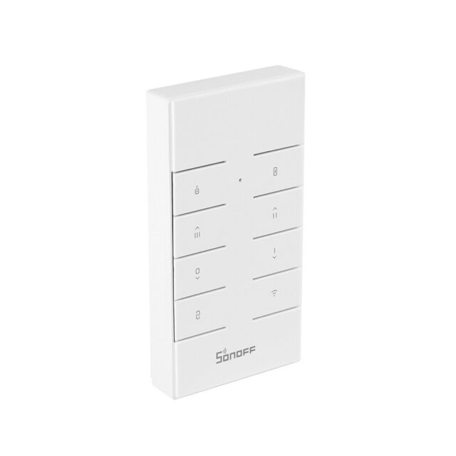

There is even the recent one that Sonoff brought out that has 8 buttons. Which I have a few of as well.
That I use for lights and volume remote for the Echo Show in the kitchen when watch Tv as the sound plays on the echo. mute doesnt work, but up volume and down volume do.

that’s only one less than the sonoff ones i have and they cost x3 the price
Yup, I agree. Usually me and my wife use just 3-4 buttons that often. Especially I have magentically mounted on bed side, so few functions named turn off/on all lights, dim night light, fan etc are the most used. Well this sonoff one looks so great. I didn’t knew they exist. Thanks again for sharing! I might try them out :slight_smile:
Oh! There you go.
well Sonoff only recently brought them out with ifan03. There is even a wall mount option, just like the Philips Hue remote
