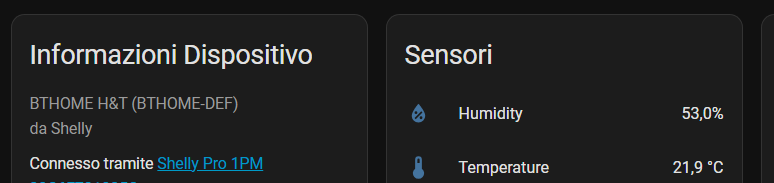

in my exploration of sensors and possible integration with home assistant I made an addition to the shellies discovery gen2 script with the mantainer in order to make it discover also non shelly bthome thermometers like the xiaomi LYWSD03MMC with the ATC custom firmware.
Release Version 3.20.0 · bieniu/ha-shellies-discovery-gen2
so now the sensor is auto discovered and added to home assistant.

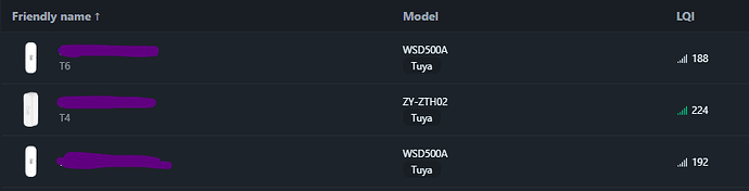

Ok i just received the sonoff dongle max adapter and i configured my first zigbee thermometer via zigbee2mqtt.
I will continue exploring it tomorrow.
EDIT: I also managed to connect a couple of tuya zigbee sensors that were not working with the official tuya hub i also have:

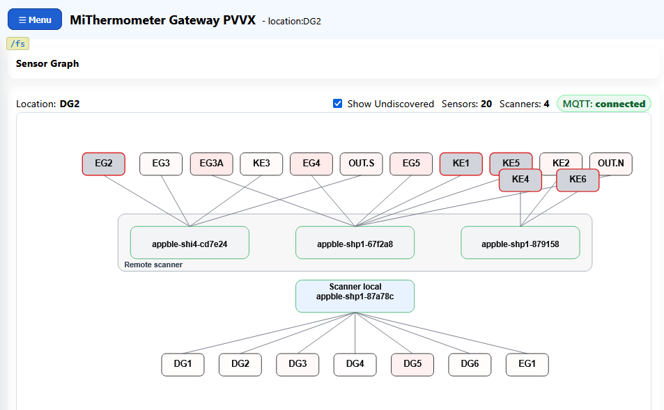

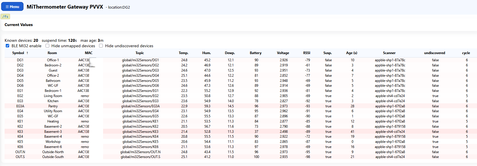

I have equipped 20 rooms with LYWSD03MMC sensors running the custom “PVVX MiThermometer” firmware.

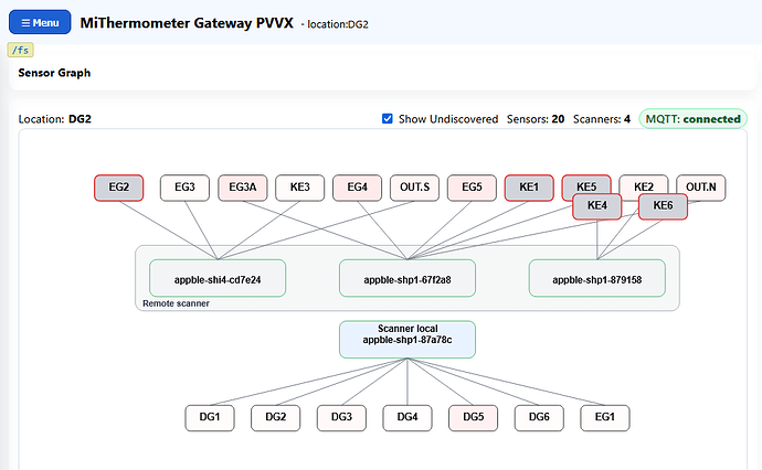

Four already installed Shelly devices (esphome) act as BLE gateways—not proxies. The gateways coordinate with one another, and the gateway with the strongest RSSI signal automatically assumes the role of provider for the respective sensor.
Sensor data is made available to other controllers via UDP broadcast and MQTT. The MQTT data model is optimized for integration with Home Assistant.
If a gateway fails, the gateway with the next-best RSSI value automatically takes over its sensors.

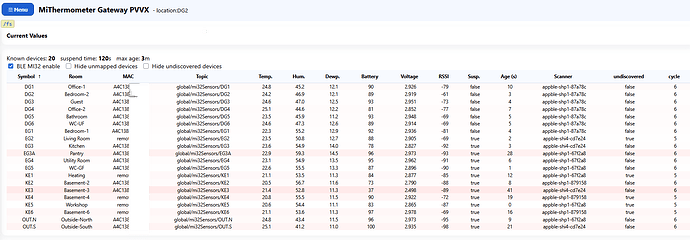

The user interface shown below is hosted directly on the gateways and provides a clear overview of which gateway is currently responsible for which sensor.

Using a Shelly device is not a requirement; any ESP32 with sufficient RAM can be used.

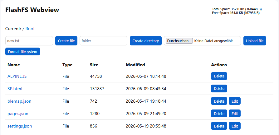

The solution requires a file system, so the flash memory needs a modified partition layout. The web application itself requires approximately 200 KB of flash storage.
UI changes can be made without recompiling, simply by uploading the modified web files.
Yes, I used several custom ESPHome components for this setup:
  • spiffs_file_server
    • serves the web file system at /fs
  • web_server_idf
    • extends the web server with project-wide async HTTP handlers
Header modules:
  • ble_mi32_tracker.h
    • BLE decoding
  • ble_mi32_mqtt.h
    • MQTT publish/subscribe and Home Assistant discovery
  • ble_mi32_udp.h
    • UDP multicast transmission and reception
  • appble_common_settings.h
    • settings.json persistence and runtime application
Very cool, that topology map!
Is this on GitHub?
