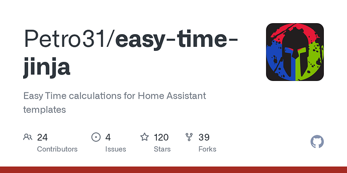

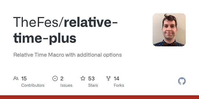

Is there anything you could use here:
Easy Time calculations for Home Assistant templates
Relative Time Macro with additional options
Thanks but I’m not sure if that helps.
I would much rather familiarize myself with in-built HA time based templating first. Then I guess I’ll be better positioned to know if I require the integration.
