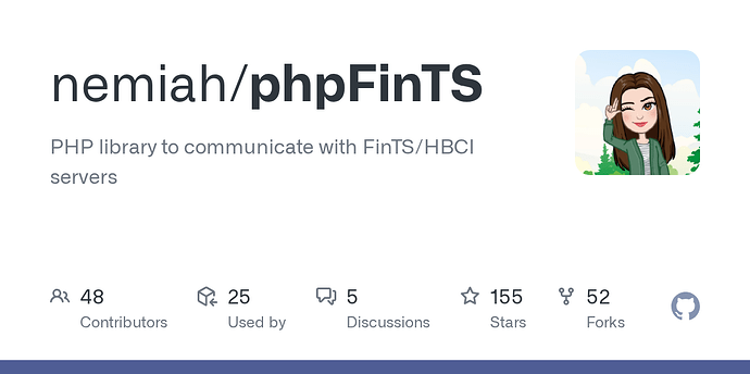

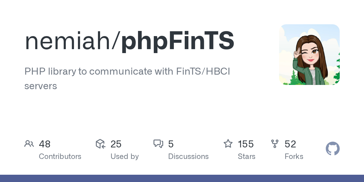

What I did is to use the existing phpFinTs project:
