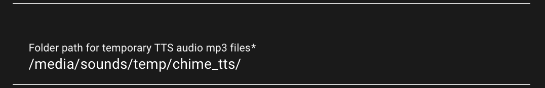

HI @Rich37804, iโ€™m sorry to hear it stopped working for you.
Can you please provide me with a screenshot of your Chime TTS configuration settings, as well as debug log messages after calling chime_tts.say_url?
Hopefully I can understand from that what the issue could be?

I think the issue lies with the folder path you have configured for the chime_tts.say action:
Screenshot 2024-10-29 at 20.22.59
Please try changing this path to a publicly accessible path (eg: /config/www/temp/chime_tts/announcements).
If you are still having issues I suggest you upgrade to the latest beta release and then let me know if the problem persists.

You need to make sure that the temporary media folder path in the Chime TTS configuration is a subfolder of a media folder, (eg: /media).
Hmmm. forgive my ignorance, but Iโ€™m a little lost here.
Currently, the temporary files are stored in: /root/media/sounds/temp/chime_tts (as verified using my SSL window)
So, I need to change this
to what?
Simply drop the โ€œ/mediaโ€ part and just use โ€œ/sounds/temp/chime_ttsโ€, (working on the assumption that โ€œlocalโ€ now maps directly to /root/media) ?
I guess Iโ€™m missing a key concept here.
No, this path is for downloaded chimes. I am talking about the temporary folder path:
Sorry, I sent the wrong screen shot (well, I took a screen shot of the wrong entry). Correct one below.
OK, now Iโ€™m really going down the rabbit hole.
In my simple mind, the path listed above seems to be correct, as (a) the generated mp3 files are actually there, and (b) we know that some (i.e. Sonos) files play OK
So, now Iโ€™ve added the โ€œlocal: /mediaโ€ entry to the config file, where is that pointing? /root/media or /root/config/www/media, or โ€ฆ?
As I said, really confused now
Youโ€™ve understood correctly. The local media folder maps to /media
I am not sure in what the issue is. My HomePod plays nicely, and our configurations appear to be very similar.
At this stage Iโ€™d suggest to delete the integration and reinstall it and try again.
