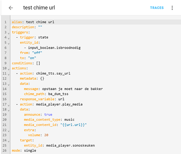

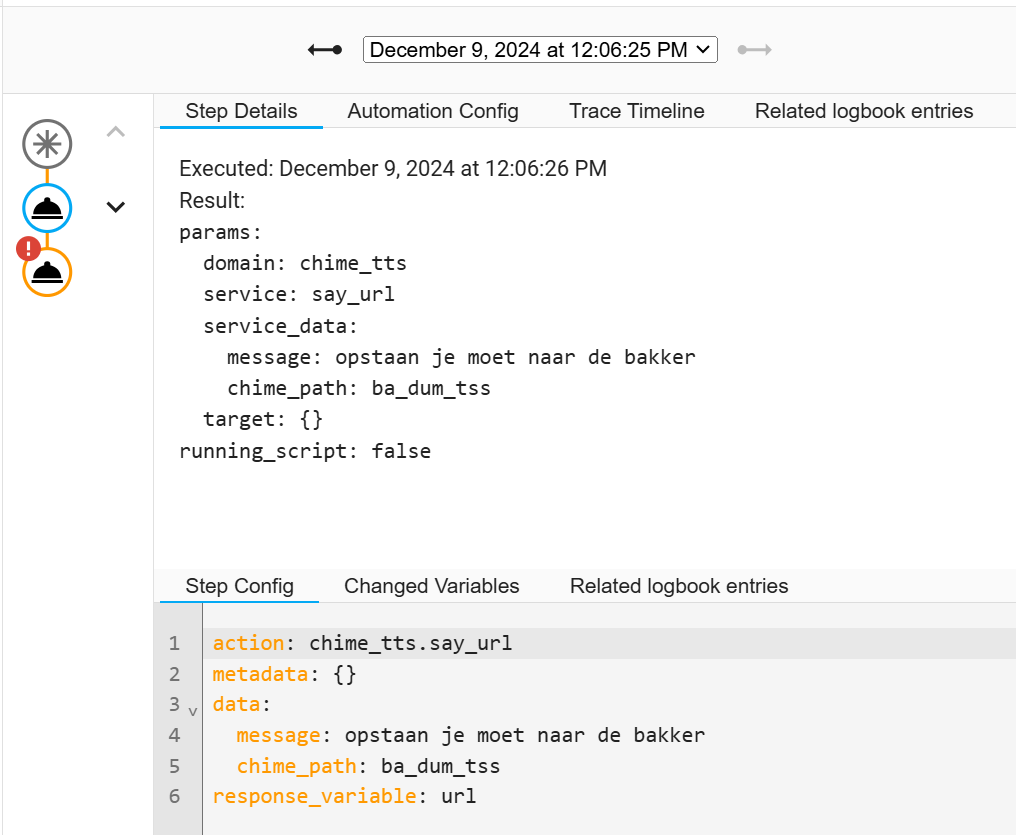

@Nimrod_Dolev apologies for the pestering, but any Idea what I might be doing wrong? Would love to move from Piper to Elevenlabs / OpenAI.
Hi @neekulp
I tried your solution, but I got a problem because my media_content_id is null while checking the trace. Iโ€™ll probably miss something. This is my piece of code
alias: test chime url

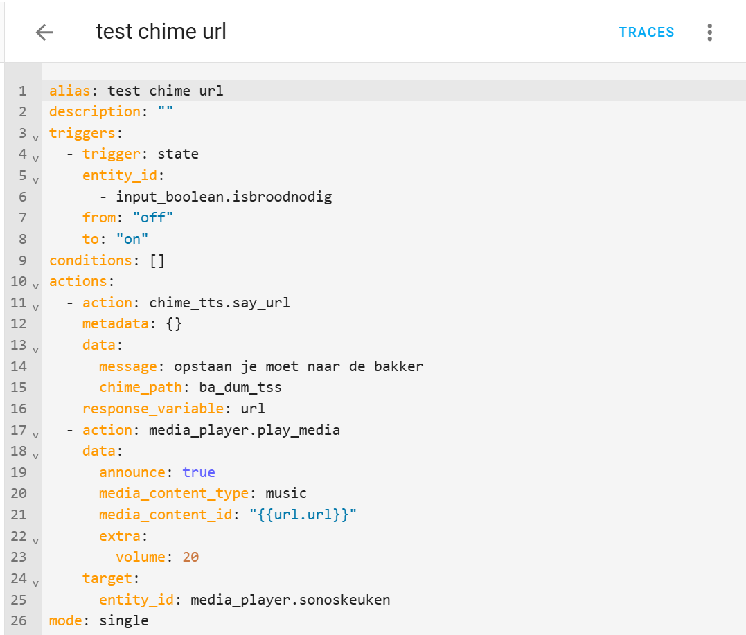

Can you share a screenshot of your yaml whilst in the automation from HA?
I canโ€™t see anything that looks off to give that trace error. It could be when saving the automation it changes the format of the โ€œ{{url.url}}โ€. I find it sometimes adds / and ".
I copied your yaml and pasted it without the trigger (below), and hit the โ€ฆ in top right โ†’ run. Works just fine for me.
description: ""
triggers: []
conditions: []
actions:
  - action: chime_tts.say_url
    metadata: {}
      message: opstaan je moet naar de bakker
      chime_path: ba_dum_tss
    response_variable: url
  - action: media_player.play_media
      announce: true
      media_content_type: music
      media_content_id: "{{url.url}}"
      extra:
        volume: 20
      entity_id: media_player.living_room_sonos
mode: single
