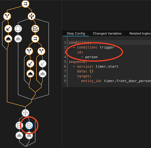

Good day… Developer with quite a bit of HA experience here, I’m seeing something quite unusual. I made an automation via the UI with two triggers with IDs. I then have two Choose components each of which have an Option conditional on the same trigger ID. However only one of them actually runs the actions in the Option. Weird right?
Check out the trace:
How can this be?

Please paste the YAML for the complete automation. Doesn’t look like it from the diagram, but you’re not overwriting the trigger are you? A wait_for_trigger or something?

No I don’t believe so…
alias: Front door motion or person
description: ""
trigger:
- platform: state
entity_id:
- binary_sensor.doorbell_motion
to: "on"
from: "off"
- platform: state
entity_id:
- binary_sensor.doorbell_person_detected
from: "off"
to: "on"
condition:
- condition: state
entity_id: input_boolean.automation_master
state: "on"
action:
- parallel:
- if:
- condition: state
entity_id: timer.front_door_motion_timer
state: idle
- condition: state
entity_id: timer.front_door_person_timer
state: idle
then:
- service: script.outdoor_sounds
data: {}
alias: Play sound if both timers idle
- choose:
- conditions:
- condition: trigger
id:
- motion
- condition: state
state: idle
- condition: state
state: active
sequence:
- service: script.announce_with_alexa
message: they're at the door
skip_suffix: true
enabled: true
alias: First motion after person
- conditions:
id:
- person
- condition: state
state: idle
sequence:
- parallel:
- alias: Announce if it's not one of us arriving
if:
- condition: state
entity_id: timer.arrival_garage_timer
state: idle
then:
message: there's someone out front
skip_suffix: true
- if:
- condition: state
entity_id: input_boolean.anyone_home
state: "off"
then:
- service: counter.increment
data: {}
entity_id: counter.door_visits_while_away
alias: If no one home increment visit counter
alias: First person trigger
- alias: Restart appropriate timer
choose:
- conditions:
id:
- motion
sequence:
- service: timer.start
data: {}
- conditions:
id:
- person
sequence:
data: {}
mode: queued
max: 10
