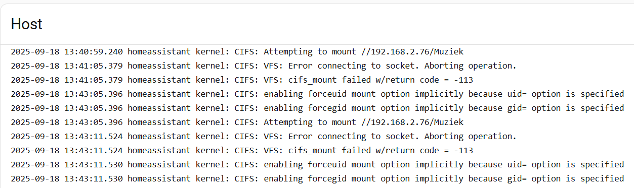

homeassistant kernel: CIFS: Attempting to mount //192.168.2.76/Muziek
homeassistant kernel: CIFS: VFS: Error connecting to socket. Aborting operation.
homeassistant kernel: CIFS: VFS: cifs_mount failed w/return code = -113

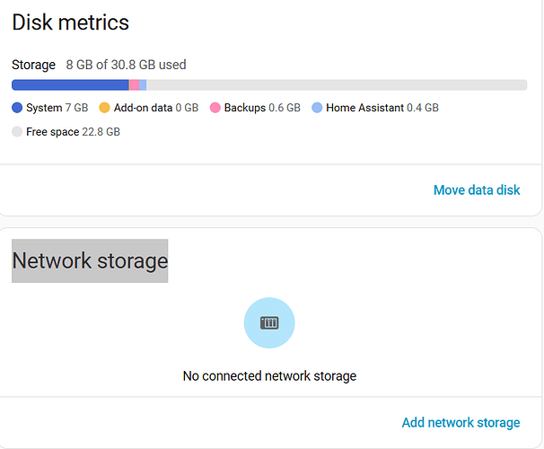

I looked in settings/system/storage/ and in Network storage there are none connected drives or whatever.

2025-09-19 01:03:31.403 homeassistant kernel: CIFS: enabling forceuid mount option implicitly because uid= option is specified
2025-09-19 01:03:31.403 homeassistant kernel: CIFS: enabling forcegid mount option implicitly because gid= option is specified
2025-09-19 01:03:31.403 homeassistant kernel: CIFS: Attempting to mount //10.0.0.118/Music
2025-09-19 01:03:31.422 homeassistant kernel: CIFS: VFS: cifs_mount failed w/return code = -13
