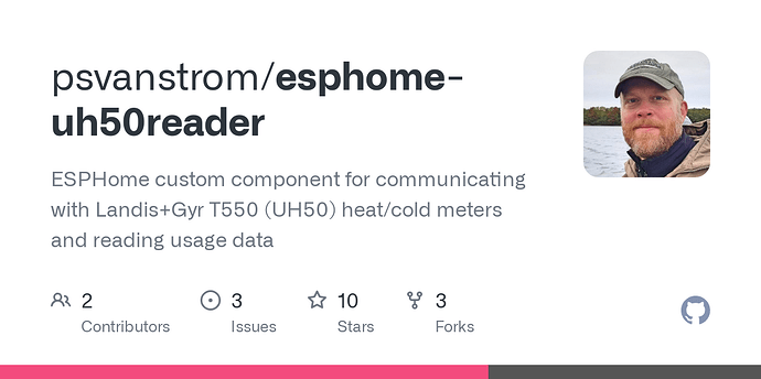

If you want a ESP uh50reader I recommend taking a look at this project:
It works great but the yaml does not work anymore since it uses the custom component platform that was removed from esphome a few months ago. I would be great if someone could see what changes are needed.
