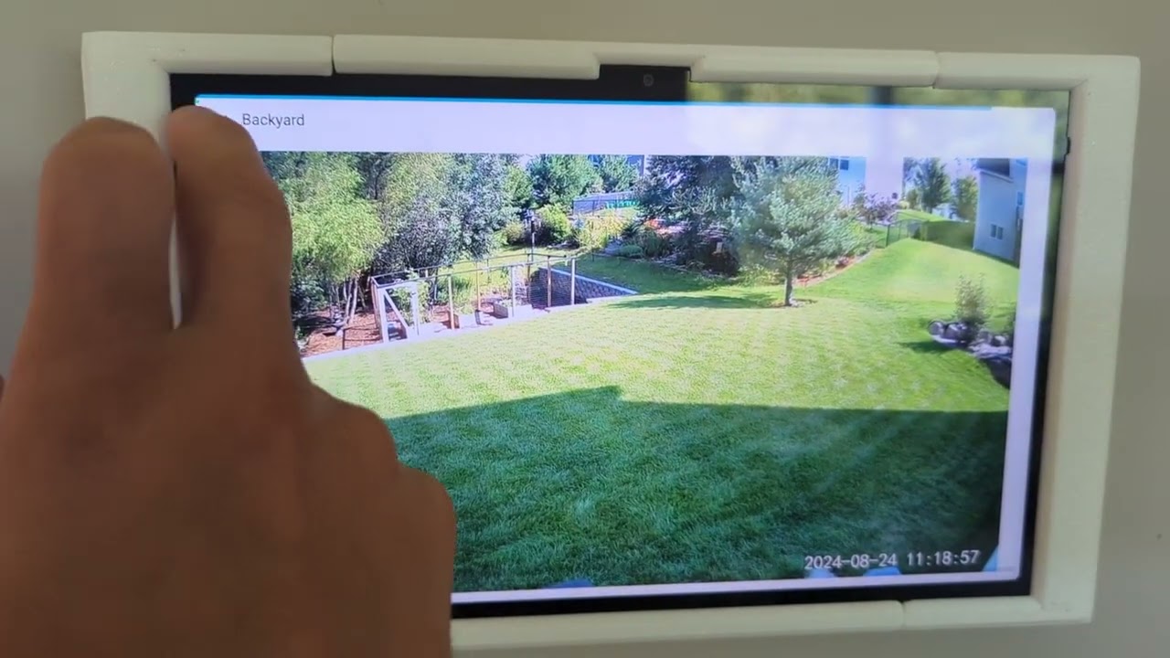

Heres how I currently solved it. There may be a more straight forward way, but this seems to work well. In case anyone stumbled on this post.
  1. Create a button helper. Need to make one for each camera.
  1. Create picture entity card with a tap action of pressing the button made in step 1.
      - show_state: false
        show_name: false
        camera_view: auto
        type: picture-entity
        entity: camera.backyward_wyze
        theme: Mushroom Square
        tap_action:
          action: perform-action
          perform_action: input_button.press
            entity_id: input_button.camera_backyard_wyze
  1. Create an automation that when the button created in step 1 is pressed, it opens a custom mod popup window.
alias: "Camera: Open backyard wyze in popup on tablet"
description: ""
  - platform: state
    entity_id:
      - input_button.camera_backyard_wyze
    to: null
    alias: Input_button is pressed
condition: []
  - action: browser_mod.popup
    metadata: {}
      dismissable: true
      timeout: 30000
      content:
        camera_view: live
        type: picture-glance
        entities: []
        camera_image: camera.backyward_wyze
      browser_id:
        - fd53b2f6e69086f422d0316735417ff3
      title: Backyard
mode: single
Heres it working in action.
