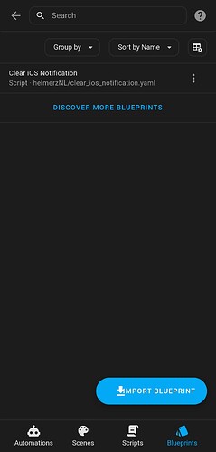

you’re blue print doesn’t appear to me at all
I even deleted all the blueprints I had to check the problem.
Ohw, I see what you are trying to do. It’s a Script blue-print. So go to the Script tab instead of the Automations
Aaaaah okay I’m just used to using Blueprint in automations thanks
