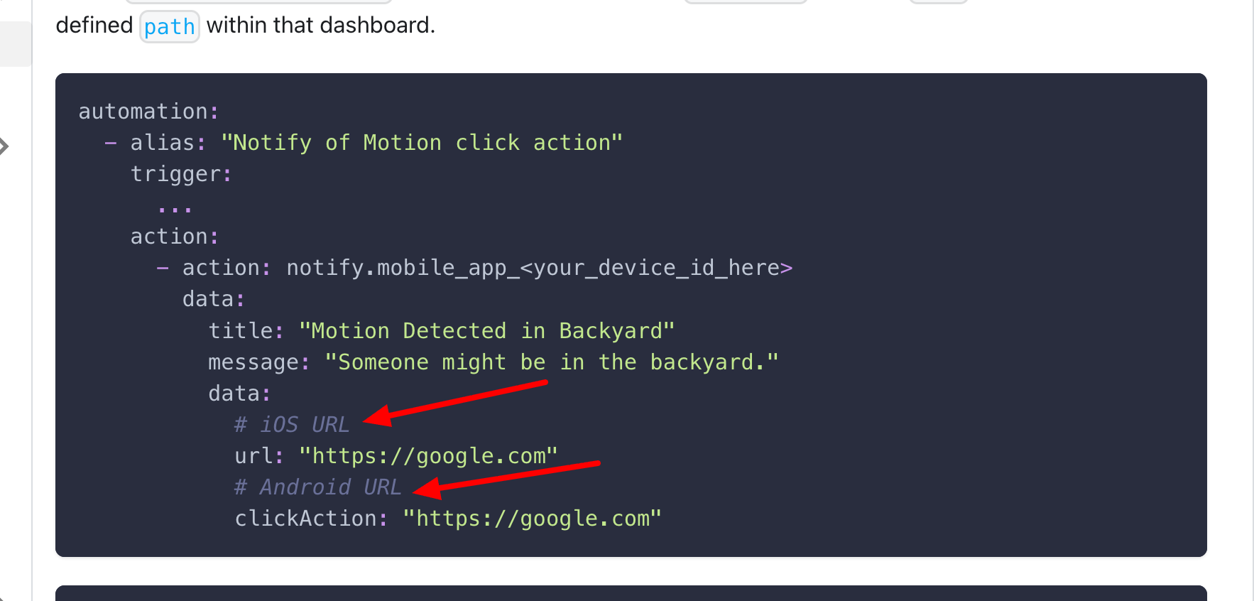

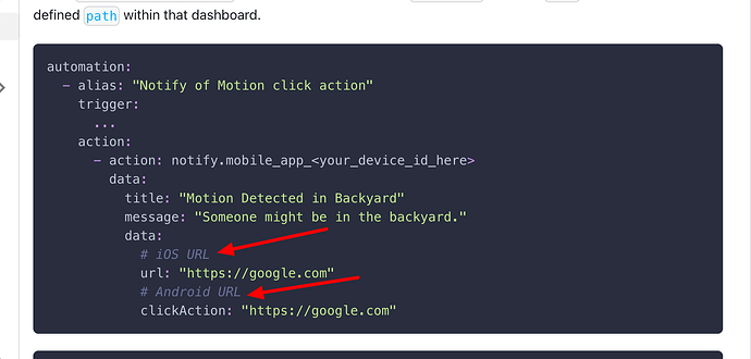

Did you see these comments in the code example in the documentation?
First try with url instead of clickAction, but I would try this example of an actionable notification. And try a simple example with fixed values before bloating the code with multiple things and dynamic templates, try things one by one and go to the dynamic part when the fixed one is working.
