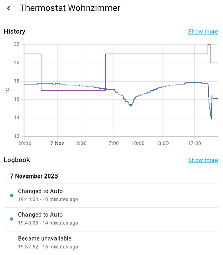

I’m using the latest HA (Core 2023.11.1, Frontend 20231030.1). I have a few heating controls (Homematic WTH-2) with integrated temperature and humidity sensors. The devices are available as climate entities in HA. I can see the current temperature and humidity and control the device. I can also see the history graph of the temperature. But how can I see the history graph of the humidity? I spent some time playing around but couldn’t find it :frowning: Is this just still missing in the UI?

I also looked at the recorder docs, but it says by default no (enabled) entities are excluded. So I think the problem is, that the climate entity is kind of a “special” entity because has more than one value: temperature and humidity. Perhaps the recorder can’t properly deal with multi-value entities and thus only one value, in my case the temperature, is logged?
It’s because those are attributes of the climate entity, now that they have their own sensors they will log if no filters are used.
Yes, I can see the history of the humidity now. Thank you!
However, it still feels like a bug to me, that the climate control doesn’t automatically record it. Also when clicking on the history button only the temperature is shown. To add the humidity alongside, the separate entity always has to be added manually… :frowning:
