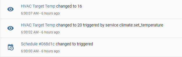

Here is what I’m seeing in the logbook:
Screenshot 2023-02-02 114838
At 6AM, the scheduler is triggered
At 06:00:02 the scheduler sets the climate target temp to 20
At 06:00:07 something sets the climate target temp to 16 (the previous value).
I’m having trouble determining what is actually is setting the temperature to 16. I have tried two different thermostat hardware, but the issue happens with both. It is intermittent and somewhat rare. There isn’t any errors or warnings shown in the log (default setup).

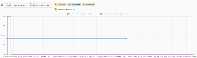

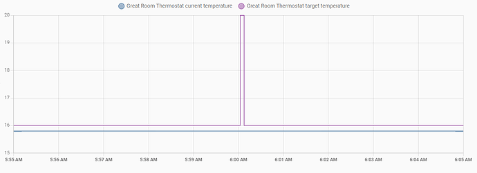

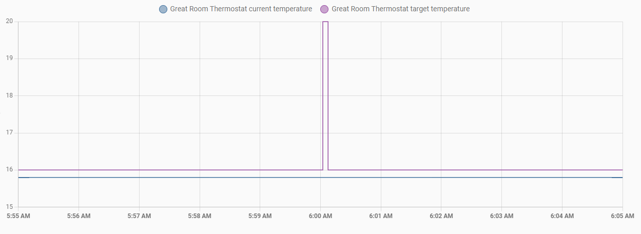

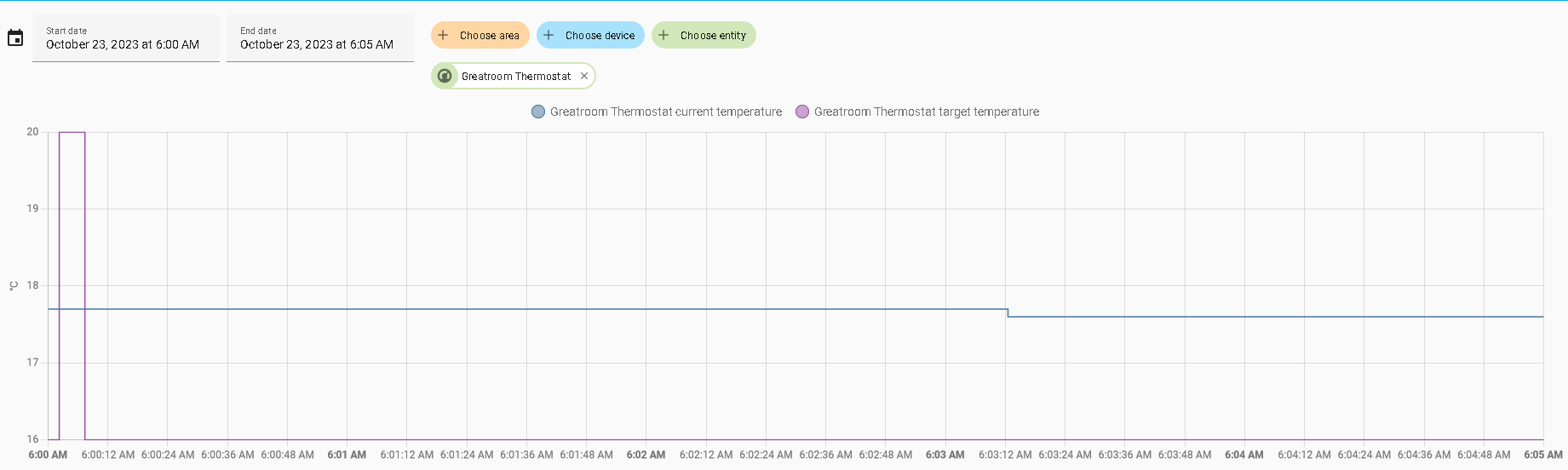

I found another instance and was able to catch the related log entries:
2023-03-02 21:30:00.003 DEBUG (MainThread) [homeassistant.core] Bus:Handling <Event call_service[L]: domain=climate, service=set_temperature, service_data=hvac_mode=heat, temperature=16, entity_id=['climate.great_room_thermostat']>
2023-03-02 21:30:00.005 DEBUG (MainThread) [homeassistant.core] Bus:Handling <Event state_changed[L]: entity_id=switch.schedule_2851cf, old_state=<state switch.schedule_2851cf=on; weekdays=['daily'], timeslots=['21:30:00'], entities=['climate.great_room_thermostat'], actions=[{'service': 'climate.set_temperature', 'data': {'hvac_mode': 'heat', 'temperature': 16}}], current_slot=None, next_slot=0, next_trigger=2023-03-02T21:30:00-05:00, tags=[], icon=mdi:calendar-clock, friendly_name=Schedule #2851cf @ 2023-03-01T21:31:00.010500-05:00>, new_state=<state switch.schedule_2851cf=triggered; weekdays=['daily'], timeslots=['21:30:00'], entities=['climate.great_room_thermostat'], actions=[{'service': 'climate.set_temperature', 'data': {'hvac_mode': 'heat', 'temperature': 16}}], current_slot=0, next_slot=0, next_trigger=2023-03-02T21:30:00-05:00, tags=[], icon=mdi:calendar-clock, friendly_name=Schedule #2851cf @ 2023-03-02T21:30:00.005555-05:00>>
2023-03-02 21:30:00.012 DEBUG (MainThread) [homeassistant.core] Bus:Handling <Event scheduler_updated[L]>
2023-03-02 21:30:02.304 DEBUG (MainThread) [homeassistant.core] Bus:Handling <Event state_changed[L]: entity_id=climate.great_room_thermostat, old_state=<state climate.great_room_thermostat=heat; hvac_modes=[<HVACMode.OFF: 'off'>, <HVACMode.HEAT: 'heat'>, <HVACMode.COOL: 'cool'>, <HVACMode.HEAT_COOL: 'heat_cool'>], min_temp=5, max_temp=35, fan_modes=['Auto low', 'Low'], preset_modes=['none', 'Auxiliary'], current_temperature=19.5, temperature=20, target_temp_high=None, target_temp_low=None, current_humidity=40, fan_mode=Auto low, hvac_action=idle, preset_mode=none, fan_state=Idle / off, friendly_name=Great Room Thermostat, supported_features=ClimateEntityFeature.PRESET_MODE|FAN_MODE|TARGET_TEMPERATURE_RANGE|TARGET_TEMPERATURE @ 2023-02-25T17:57:19.434535-05:00>, new_state=<state climate.great_room_thermostat=heat; hvac_modes=[<HVACMode.OFF: 'off'>, <HVACMode.HEAT: 'heat'>, <HVACMode.COOL: 'cool'>, <HVACMode.HEAT_COOL: 'heat_cool'>], min_temp=5, max_temp=35, fan_modes=['Auto low', 'Low'], preset_modes=['none', 'Auxiliary'], current_temperature=19.5, temperature=16, target_temp_high=None, target_temp_low=None, current_humidity=40, fan_mode=Auto low, hvac_action=idle, preset_mode=none, fan_state=Idle / off, friendly_name=Great Room Thermostat, supported_features=ClimateEntityFeature.PRESET_MODE|FAN_MODE|TARGET_TEMPERATURE_RANGE|TARGET_TEMPERATURE @ 2023-02-25T17:57:19.434535-05:00>>
2023-03-02 21:30:02.313 DEBUG (MainThread) [homeassistant.core] Bus:Handling <Event state_changed[L]: entity_id=sensor.hvac_target_temp, old_state=<state sensor.hvac_target_temp=20; friendly_name=HVAC Target Temp @ 2023-03-02T06:00:02.327935-05:00>, new_state=<state sensor.hvac_target_temp=16; friendly_name=HVAC Target Temp @ 2023-03-02T21:30:02.313194-05:00>>
2023-03-02 21:30:07.399 DEBUG (MainThread) [homeassistant.core] Bus:Handling <Event state_changed[L]: entity_id=climate.great_room_thermostat, old_state=<state climate.great_room_thermostat=heat; hvac_modes=[<HVACMode.OFF: 'off'>, <HVACMode.HEAT: 'heat'>, <HVACMode.COOL: 'cool'>, <HVACMode.HEAT_COOL: 'heat_cool'>], min_temp=5, max_temp=35, fan_modes=['Auto low', 'Low'], preset_modes=['none', 'Auxiliary'], current_temperature=19.5, temperature=16, target_temp_high=None, target_temp_low=None, current_humidity=40, fan_mode=Auto low, hvac_action=idle, preset_mode=none, fan_state=Idle / off, friendly_name=Great Room Thermostat, supported_features=ClimateEntityFeature.PRESET_MODE|FAN_MODE|TARGET_TEMPERATURE_RANGE|TARGET_TEMPERATURE @ 2023-02-25T17:57:19.434535-05:00>, new_state=<state climate.great_room_thermostat=heat; hvac_modes=[<HVACMode.OFF: 'off'>, <HVACMode.HEAT: 'heat'>, <HVACMode.COOL: 'cool'>, <HVACMode.HEAT_COOL: 'heat_cool'>], min_temp=5, max_temp=35, fan_modes=['Auto low', 'Low'], preset_modes=['none', 'Auxiliary'], current_temperature=19.5, temperature=20, target_temp_high=None, target_temp_low=None, current_humidity=40, fan_mode=Auto low, hvac_action=idle, preset_mode=none, fan_state=Idle / off, friendly_name=Great Room Thermostat, supported_features=ClimateEntityFeature.PRESET_MODE|FAN_MODE|TARGET_TEMPERATURE_RANGE|TARGET_TEMPERATURE @ 2023-02-25T17:57:19.434535-05:00>>
2023-03-02 21:30:07.407 DEBUG (MainThread) [homeassistant.core] Bus:Handling <Event state_changed[L]: entity_id=sensor.hvac_target_temp, old_state=<state sensor.hvac_target_temp=16; friendly_name=HVAC Target Temp @ 2023-03-02T21:30:02.313194-05:00>, new_state=<state sensor.hvac_target_temp=20; friendly_name=HVAC Target Temp @ 2023-03-02T21:30:07.407266-05:00>>
The state change event for the thermostat is there,immediately followed by the “reverse” state change…
Is there any advise out there to help determine what is causing the thermostat to set the target temp “back” after 5 seconds?
