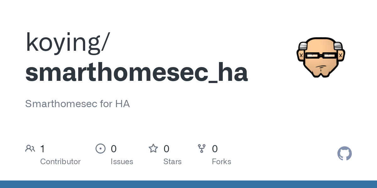

I also have a Vesta system, but no local access, so I hacked together an integration that talks to the Smarthomesec website.
It allows to control the alarm, and receives event from devices (same as you would get on the website).
I just post it in case it would help some, no support given.
Thanks, it works like a charm

I installed : smarthomesec_ha-main as described … and then ? I do not see anything in HA after reboot. Thanks.
