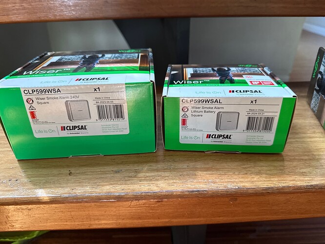

Photo of box for those who are interested. The wired version is a larger device than the wireless version. Otherwise the contents of the box are the same and the instructions for use are the same.

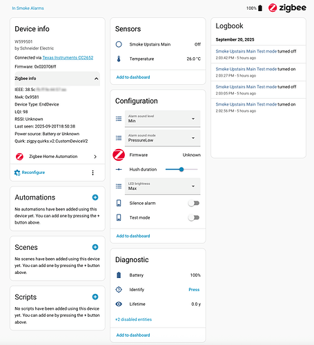

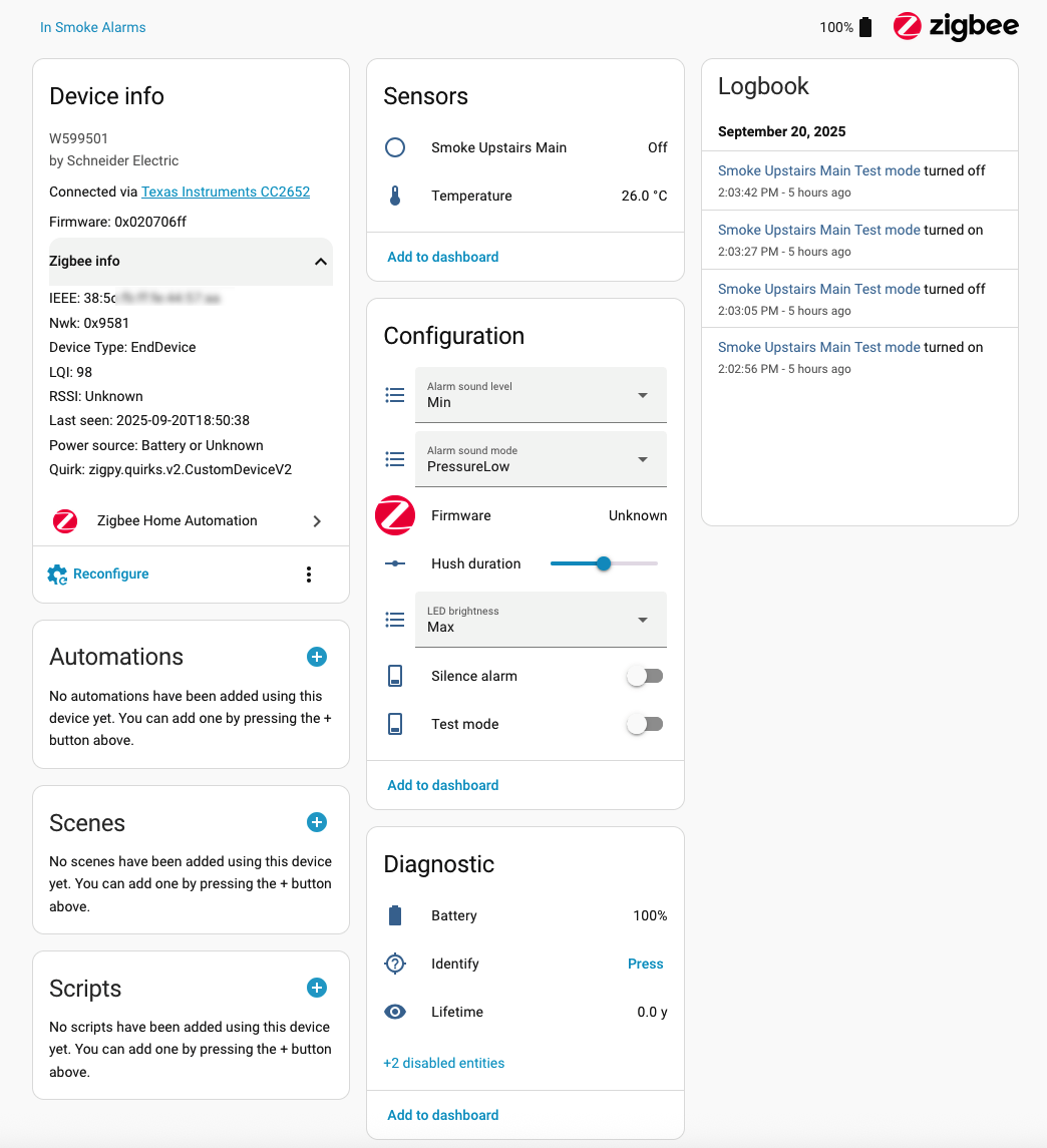

Coming back to this now that the firmware version is showing:
How does that compare to yours?
Same firmware here…
Interesting. Did the test button ever start working for you?
Nope… none of the buttons work, I can only read the sensors and even then they only update every few hours.
