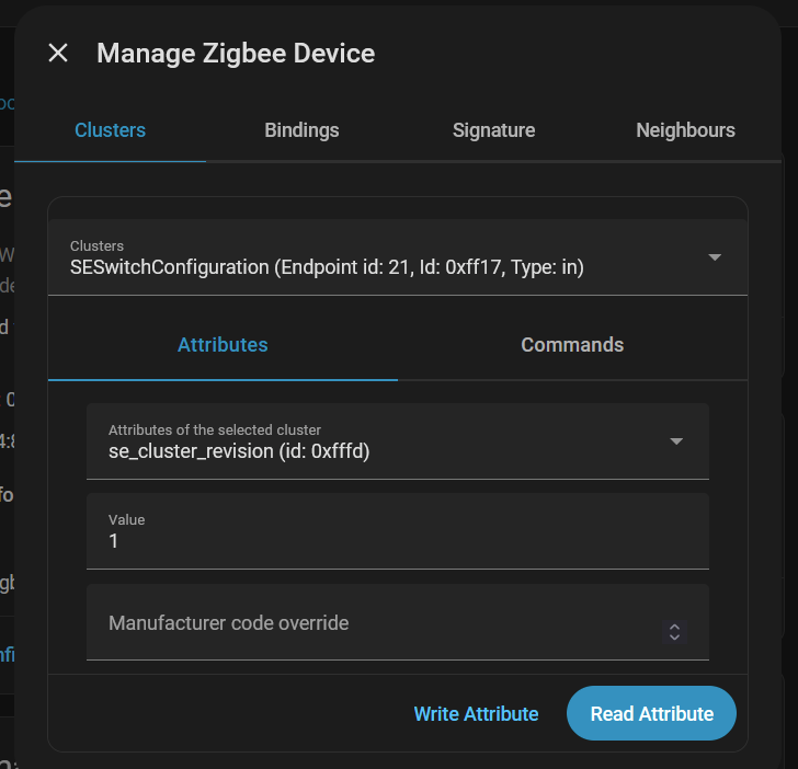

Yes, I did. You need to go the device page, than Manage Device and pick the correct cluster and update it as per the options listed above.

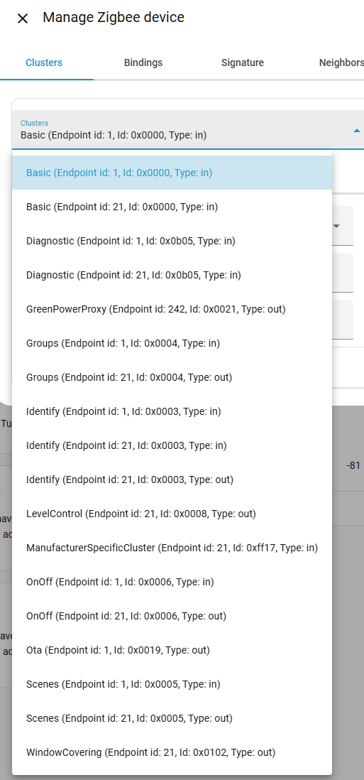

If the manufacturer cluster isn’t there, try removing the device from ZHA and re-adding it.
Thanks for your reply. I tried removing and re-adding the switch from ZHA, restarting HA, but I still do not have the SESpecific Cluster option under my device.

I found one of your other comments (Clipsal Wiser in Australia. Can it be integrated into HA? - #75 by Orange-GT3) that linked to the ZHA Toolkit. I followed that and have set it manually.

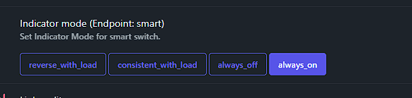

it shows in z2mqtt and you can control it like this

Go to the device and ‘Manage device’ and then set this cluster:
The valid values are:
  • 0 = backlight is on when load is on;
  • 1 = backlight is always on,;
  • 2 = backlight is on when load is off; and
  • 3 = backlight is always off.
