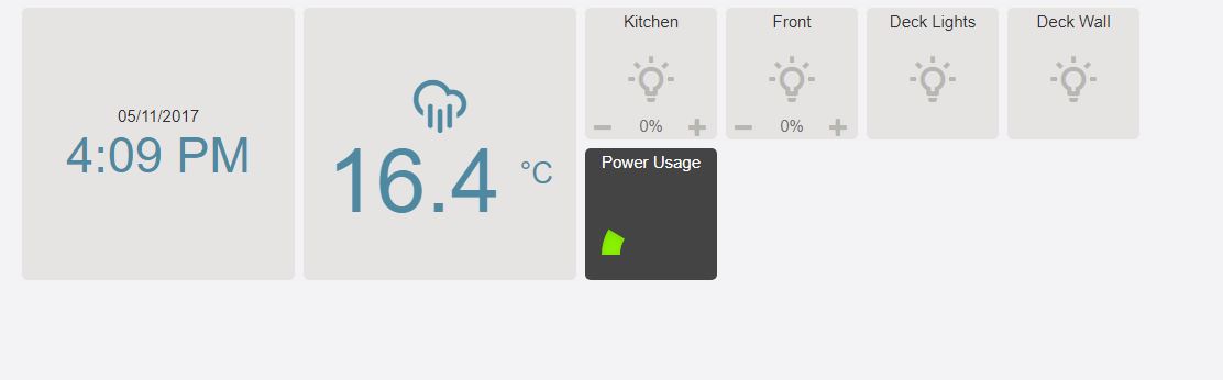

Hi
I am using the hygge theme and am having osme issues
What i would like to see is the clock in a large font, but the AM/PM in a small font
id like to adjust the date to be a bit larger
the gauge, as you can see has a black background so i cannot see the text
clock:
widget_type: clock
widget_style:"font-size: 200%;"
time_style: "font-size: 450%;"
gauge-elecusage:
widget_type: gauge
title: Power Usage
units: “W”
min: 300
max: 3000
low_color: 4CFF00
med_color: FFD800
high_color: FF0000
entity: sensor.energy_usage
thanks in advance!
Capture|690x214
try leaving out fontsize for the widget and just manipulate the css from the time_style.
you can use any css you like so you can change it to every size you like.
it seems that your gauge has no set variables in your skin.
in the variables.yaml from the skin you use there should be lines like:
gauge_widget_style: $background_style
gauge_title_style: $style_title
gauge_title2_style: $style_title2
gauge_low_value_color: “$blue”
gauge_med_value_color: “$blue”
gauge_high_value_color: “$blue”
gauge_value_bgcolor: “$gray_medium”
gauge_text_color: “$blue”
Thanks, that dosnt appear to work
i added the following to the variables.yaml inside my hygge skin directory, but get a 500 internal server error when loading the dashboard/skin, removing those lines fixes it
probably a problem by copying.
its yaml.
so no strange things may happen in the file.
some editors change spaces to some wierd things.
when i have something like that happening i erase every space i can find after i copy pasted the text and replace it with a real space.
those lines need to be there if you want to use the gauge.
and they are also in other skins.
you could also copy those lines from the default skin.
