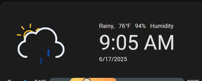

Just responded in another thread less than two weeks ago here
This actually one field with a <br>
Test this
type: custom:clock-weather-card
entity: weather.forecast_home
show_humidity: true
card_mod:
style: |
clock-weather-card-today-right-wrap-top {
word-spacing: 7px;
clock-weather-card-today-right-wrap-top br {
display: none;
[image]
