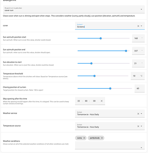

Hi!
I’ve installed your blueprint and configured it. But I cannot get it to work. Please find my settings attached. Do you see anything weird?
Try playing around with the positions start and end as well as the elevation. Set the states of those in developer tools > states and see if they do anything. I would also check the opening and closing values of your screen entity. Sometimes they are reversed.
I tried but really can’t get it to work… Do I need to add any sensors before importing this blueprint?

Hi!
Cover is a shelly which is connected to a sunscreen. Only up or down possible. This works by hand :slight_smile:
Sun integration is working as well.
No temperature sensor but I assume it takes the temperature from the tomorrow.io.
Weather service I have changed to tomorrow.io… Lets see if it changes anything… Is there else a way to test with different parameters to activate the blueprints action?
