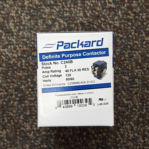

Contactor (or equivalent model)

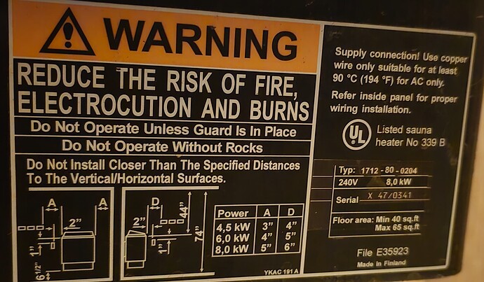

Thanks ! Here is a picture of the label at the bottom. This is an Amerec 1712-80-004 .

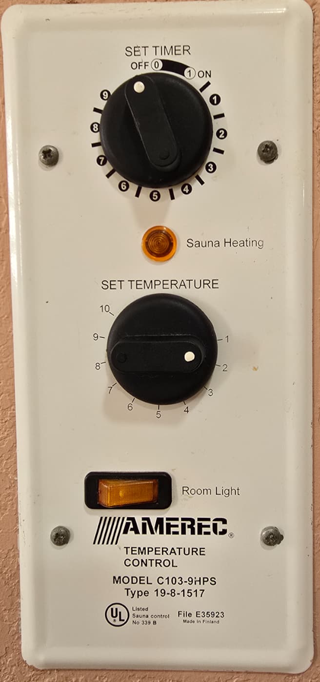

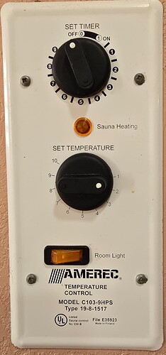

The controller is an Amerec C103-9HPS .

Thanks. I see that the contactor says it “complies with UL bulletin 508”, but not UL listed. Not sure what an insurance company would make of it.

You can choose another contactor if needed.

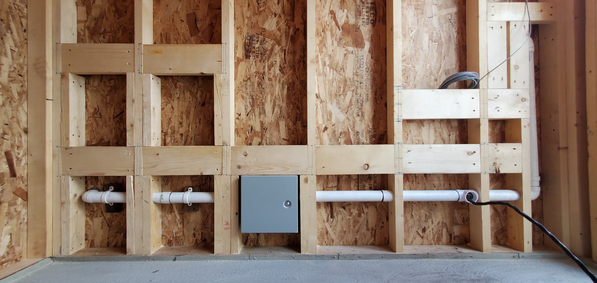

The contactor is located inside the sauna, in a steel NEMA box
https://www.amazon.ca/dp/B005UPA0RS

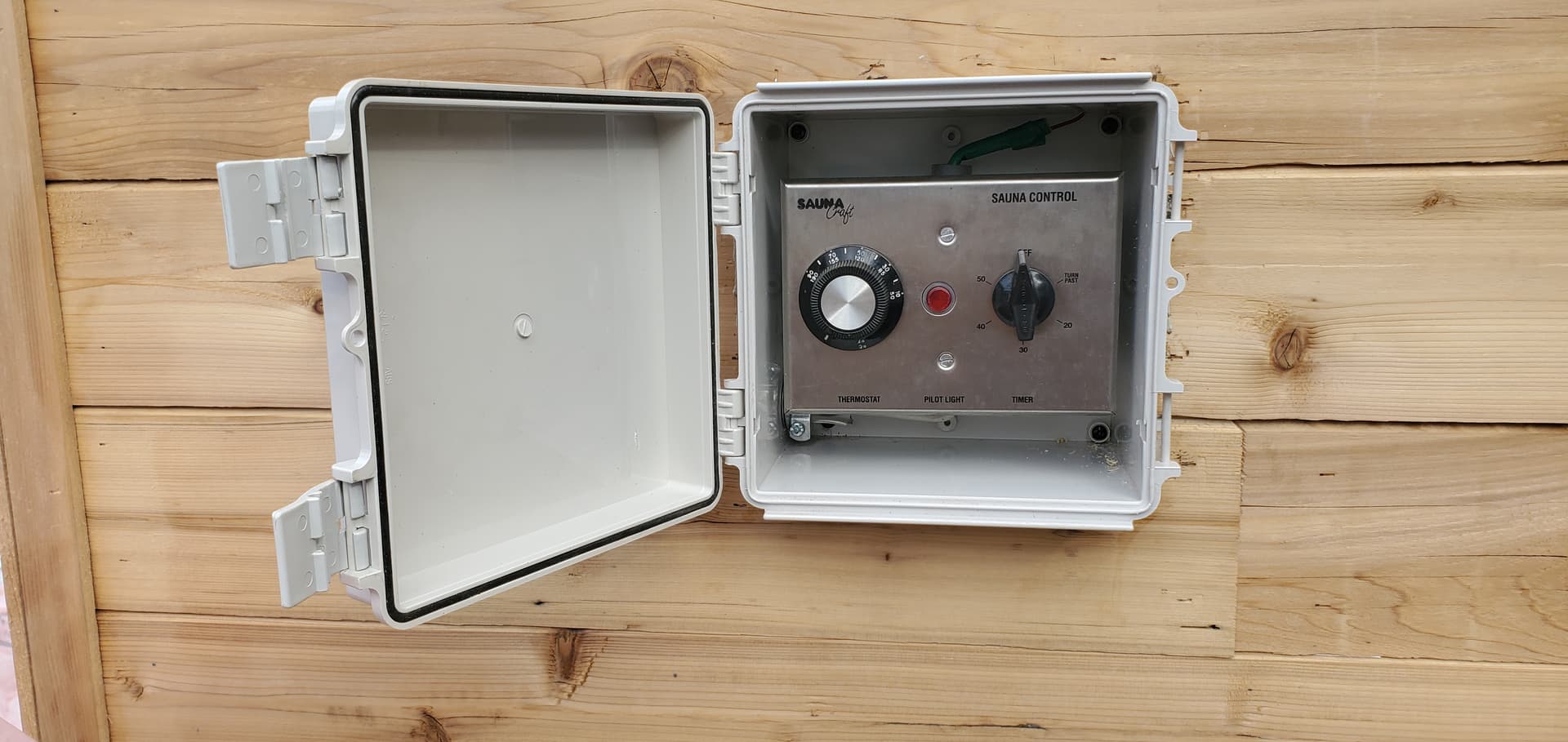

The control panel is outside, also in a NEMA box.
https://www.amazon.ca/dp/B005T6S9H6

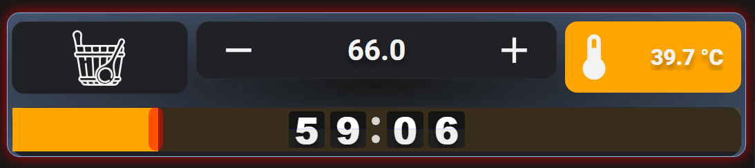

However, I generally use the Home assistant dashboard on my wall mounted tablets to preheat the sauna, control the timer, check temperature, etc. Especially in the winter months… :cold_face:

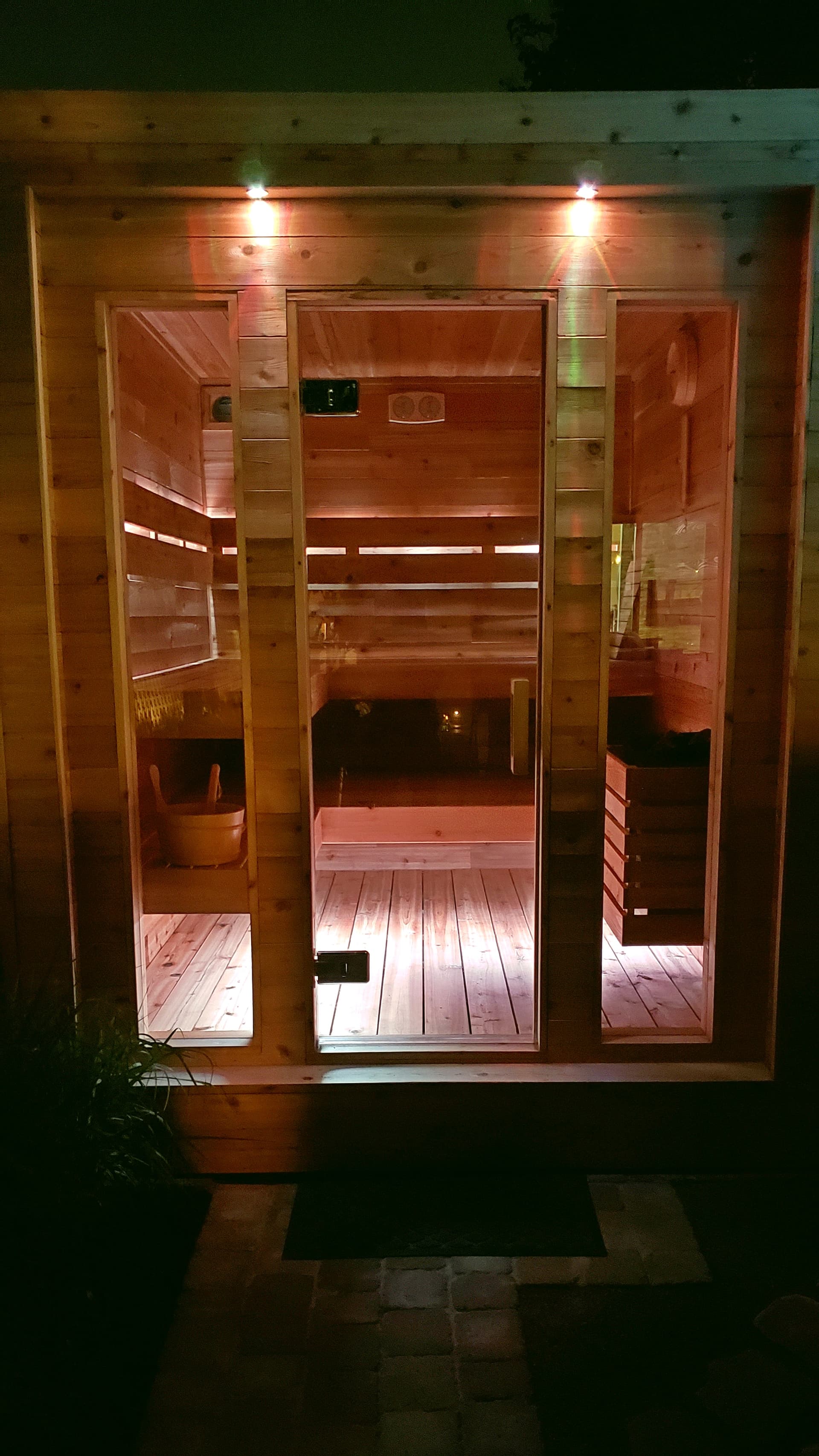

The dev board is located just under the control panel, in its own enclosure (not shown, picture taken prior to final installation)
It also contains a second ESP32 for WLED lighting:
