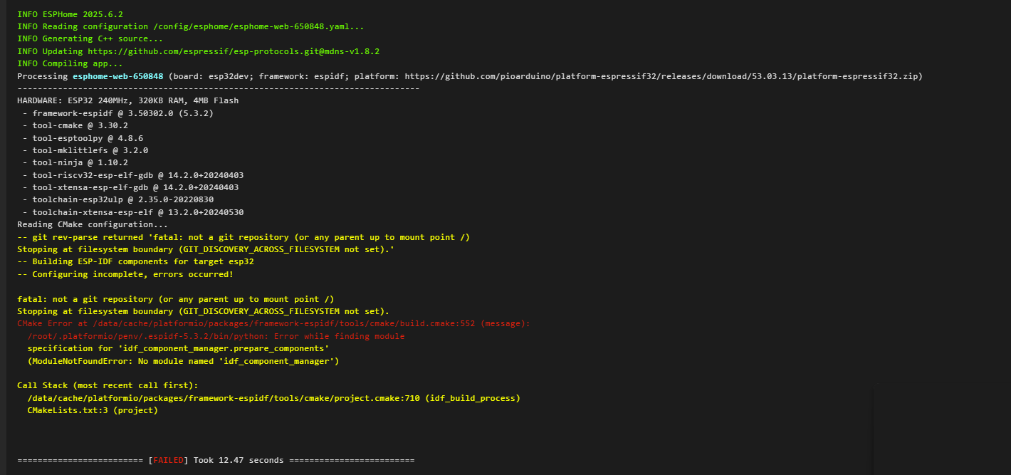

If you share your code we will be able to tell which git repository doesn’t exist. Maybe? ![]()
esphome:
friendly_name: 3D-Drucker2
min_version: 2025.5.0
name_add_mac_suffix: false
esp32:
board: esp32dev
framework:
type: esp-idf
# Enable logging
logger:
# Enable Home Assistant API
api:
# Allow Over-The-Air updates
ota:
- platform: esphome
wifi:
ssid: "yyyy"
password: "xxxx"
Try arduino instead of esp-idf for framework type.
Your indentation is out in your OTA section, try that first.
ota:
- platform: esphome
Hi - how are you running ESPHome? As an add-on? Python on a Mac or PC?
