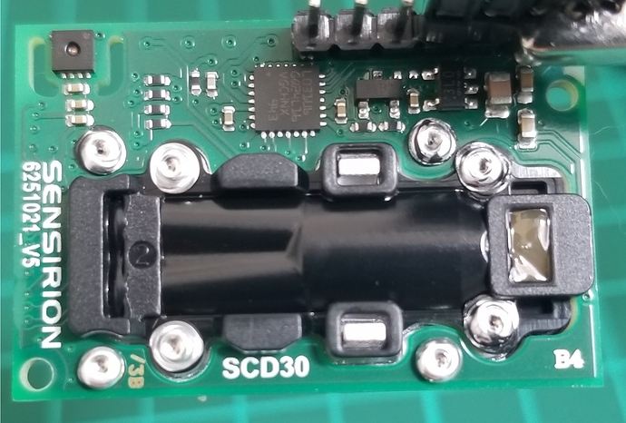

Here’s a detail of the sensor in operation, the glowing light is the infrared source necessary to analyze the air samples:
