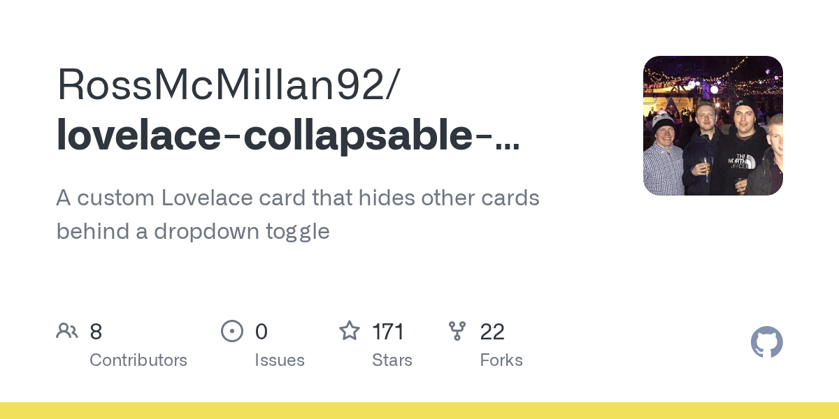

it says custom: in your YAML, so it is a custom third party card.
You need to find the GitHub page for that card and then post the issue there or if the author of the card have made a thread on the forum, then find that particular thread and reply to that.
The GitHub repo does not have an issues or wiki section - and there is no thread on the forum.
A custom Lovelace card that hides other cards behind a dropdown toggle

I tried to PM @rossmcmillan92 here but never got a reply.
There is no active fork.
Dead. Right?

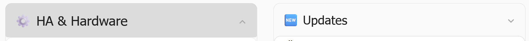

a) configured to only expand per default for desktop screens only (or never or always)
b) styled like collapsable-card can (even natively) as I mainly use collapsable cards for main/outer cards like
type: custom:collapsable-cards
title: ⚙️ HA & Hardware
defaultOpen: desktop-only
buttonStyle: "font-size: 26px; background-color: var(--divider-color);"
cards:
title: 🆕 Updates
buttonStyle: "font-size: x-large;"

Migrated to expander-card. Actively maintained, besides few optical glitches/differences almost same output.
