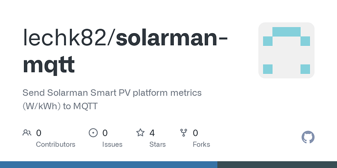

Indeed, I had the same that the token was expired. Now I am trying to make it work with this project below, so you don’t have to care about the token refresh. I have it partially working with the docker container.
Hello @lechk82
Many thanks for sharing your project. I am experimenting with your docker image and retrieve data. The container log shows:
INFO:root:2021-12-13 21:25:37 - 1.0 kWH day total and currently 0.0 W
etc… but no errors
The MQTT explorer shows only:
solar/energy
solar/power
I was expecting to see more topics.
  • Do you have any idea`s what could cause this?
  • Where can I see more log information? I did also enable debug in config.json but don`t know where to look for those logs.

@Damian_Nelson, after spending much time trying to make the docker container working I gave up. I use the python script instead and this works perfect!
UPDATE: Found that the docker container also works perfect. I tested it with the exact settings as described in github project page.
I added a datalist check since it appears to be sometimes unpopulated by the solarman api.
What architecture (x64? arm?) are you trying to run the docker image on? the base image currently does not support arm
EDIT:
Docker Image now available for platforms: linux/amd64 linux/arm/v7 linux/arm64
(Tested on odroidn2+ (arm64) and PC (linux/amd64)
Could you please post the whole output with debug enabled.
