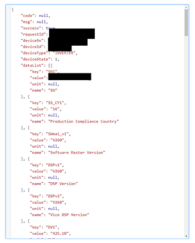

Check to make sure you can see data from your inverter. Paste this into the box on the left, replacing values as appropriate.
curl --request POST \
  --url 'https://api.solarmanpv.com/device/v1.0/currentData?appId=<appId>&language=en&=' \
  --header 'Authorization: bearer <accessToken>' \
  --header 'Content-Type: application/json' \
  --data '{
	"deviceSn": "<deviceSerial>"
You should get the following result (truncated for here)
