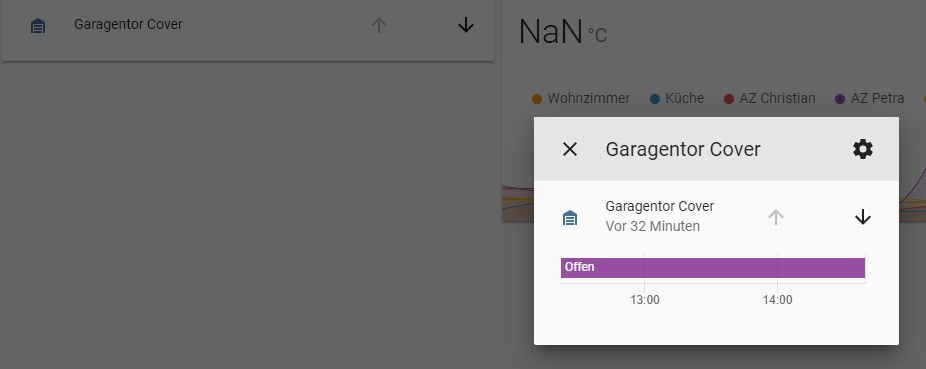

The binary sensors outputs on/off state for open/close. The Template itself shows the correct icon, but the state is still opend. Is there no possibilites to change the default state to closed?

Yes, see at the screenshots.
