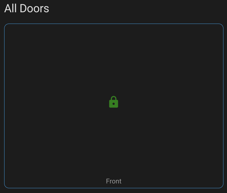

If you do all your doors like this, you should see:
And each door shows the corresponding state and colours!
Next up… the toggle.

With this, you can click on the front door icon and lock, or unlock it with a press. The only drawback is that you can lock it while the door is open - the advantage is that you can actually see that state in the icons, so you can see you messed up:

I was working on some zwave configs, and because of that, I was also able to verify the “unknown” state for these icons while the zwave was down:
Ok, I think I have what can be considered the solution. First, here is what the card looks like, I have it stacked with two rows. Also, each button will toggle and lock/unlock locks or open/close garages. The color and icon of each will change according to the state:
Here is the GUI side code to make that work:

and it blows up just like this
but if I comment out that line then I get this card
so it’s definitely something it doesn’t like trying to use that template that should be there and should work.
I just manually entered the card with your code in Home Assistant by going to Edit → Add Card → Manual and pasted in your code. I then changed the name of the sensor to match mine, but otherwise left everything the same. It works for my door, but has the wrong icon:

My guess is that you need something in there like my sensor.yaml? Thats doing half the work for me.
Yeah it’s weird. I have the sensor.yaml set up and when I build out my entire card it works just fine as you can see in the image below. The colors and icons are being accurately reflected but as soon as I add the “template: menu_button” line it blows up. To be perfectly honest I don’t know what I’m not getting out of not having it so maybe it doesn’t really even matter.

The card looks good and accurately reflects the states of the locks and cover. I even tested open/close of the garage door, and got the up and down arrows.
So I’m not really sure what the actual issue is unless you can tell me what that template: menu_button does?
Anyway thanks for all your help so far.
I mean, if it does what you want, and works without it, then don’t use it! I totally forget why I used it for mine now, been a few months since I figured out how to make it work, and is has been working perfectly ever since.
Thanks again…now I have to get the YAML formatting so I can embed this inside another series of cards…yuck.
