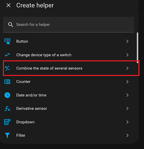

That looks really useful, but it doesn’t show on my system for some reason !

Yeap… found this, it is now under Min/Max. seems to work OK. I would still like to understand the coding as I like to learn and now that I am getting into HA I think it is important to understand these things.
What exactly doesn’t show?
Info about the helper (integration): Min/Max - Home Assistant
