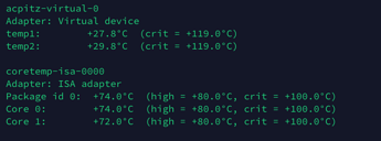

I’ve checked the temperature in command line using lm-sensors.
04
Noticed the machine has Virtual device temperatures. Might be because of the virtualenv I installed HA to.
These 75 Celsius degrees seems much more realistic to me.

here is another scan, I made with lm-sensors.
27.8 Celsius again, for temp1 as I mentioned, it might be connected to the Adapter: Virtual device. Because Adapter ISA adapter is showing different values as it showed yesterday.
Not the scan_interval is the problem, but the source it’s getting the temperature from.

I think I figured it out. ran cat /sys/class/thermal/thermal_zone*/temp, and I found it shows me the real adapter, I was trying to read, the whole time.
I believe the “Virtual device” adapter is a fake CPU temperature, and it never changes.
Pushed my CPU to 100% process again, and it didn’t change, but ISA adapter did.
Assuming in the original command we were reading zone0, and zone* showed me several values, I started experimenting, till I found zone2 is the value I want to see.
And voile:
