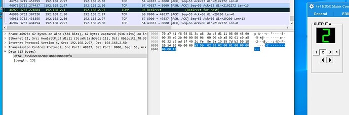

Here is what I can see in Wireshark:
And here is my command line switch:

but I’m not seeing any activity on wireshark when I operate the switch.
Which suggests that my connection outward from HA isn’t working. Nothing showing in any logs.
