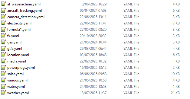

Great, I am not sure why ‘packages’ seems to get little attention as for me it makes it a lot easier to maintain my yaml based stuff grouped in a file of my liking :slight_smile:
I have dozens of those yaml entities
