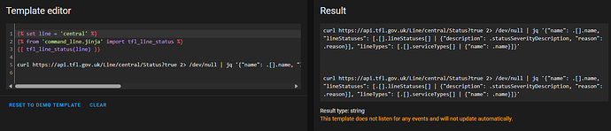

But I want to use a macro to define the repeating command line like this
  - sensor:
      name: TFL TEST Central Line
      unique_id: tfl_test_central
      command: >
        {% set line = 'central' %}
        {% from 'command_line.jinja' import tfl_line_status %}
        {{ tfl_line_status(line) }}
      value_template: *line_state
      json_attributes: *line_attributes
      command_timeout: 55
Macro:
{% macro tfl_line_status(line) %}
    curl https://api.tfl.gov.uk/Line/{{ line }}/Status?true 2> /dev/null | jq '{"name": .[].name, "lineStatuses": [.[].lineStatuses[] | {"description": .statusSeverityDescription, "reason": .reason}], "lineTypes": [.[].serviceTypes[] | {"name": .name}]}'
{% endmacro %}
In the template dev tool the macro returns the correct command
But the sensor itself is unknown
Any suggestions as to why this won’t work?
Thanks
