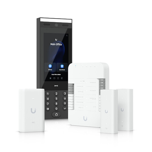

As @TH3xR34P3R said, i strongly recommend you go with the Unifi Door Access Kit. You can start with just the door access. But eventually you’ll buy into their network, camera, and phone ecosystem. I have it installed on my apartment complex and love it. Integrates with home assistant beautifully too.
You have two options:
or
I went with option B, its marketed as gate access because, yes it can open gates and doors. I use this mostly because of the size of the device suits main entry access more. I have several of their cameras as well and i love it!
Do keep in mind with either of their kits you’ll need one of their gateways to go with it as well. Gateways run the software in your case you’ll be running two (Unifi Access: Manage door settings passcodes etc, Unifi Protect: Manages the recordings from the camera on the door) Yes the software is free to use.
