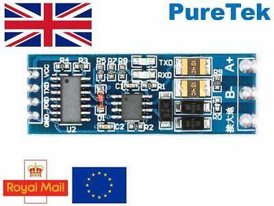

All you need is an esp (nodemcu or similar), a cheap rs485-ttl converter module (ebay/aliexpress they’re about $2). It fits in the existing wifi stick case (lots of spare room).

Could a NodeMCU board such as this be used in place of the D1 mini
And is this correct

Do you think the 2 items I’ve put links to above connected together as per you Github drawing would work with the solis wifi dongle
A photo of your completed unit showing to soldered / connected wires would be a great help

Hello! Those two look ideal.
  • Any node-mcy/wemos board should do (smaller the better though). The only requirement is it must accept 5V input (anything with a usb on it should).
  • The TTL RS-485 converter you’ve shown there is perfect; same one I used.

I have been using the blue USB-485 adapter in the photo but i have to say its output signals look pretty poor & noisy on a scope - (although it does work happily on my Solis 4G mini!) i’ve also tried my arduino setup with a MAX485 which has cleaner signals. Still Nothing!!
I’ve also ordered the black adaptor to try plus the module board which I can drive from an FTDI USB-UART device.
