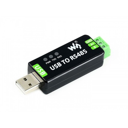

Hi Will,
Do you know if the integration works with something like this:
I’m building next year and the builder uses solis inverters.
I’m planning cabling now and thinking to put a rj45 point next to the inverter, bring the rs485 back to the above (rs485 over cat6) sitting somewhere near my patch panel. Maybe into a raspberry pi but maybe to a vm if passthrough works ok.
Cheers !
Yea it should work fine.
But wouldn’t an Ethernet-RS485 adaptor give you greater flexibility as you don’t need to plug it physically into the Pi / VM?
Yes that’s a much better. Thank you !
