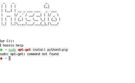

  1. Install the SSH & Web Terminal addon
  2. Connect over SSH to your HassIO instance by using the new addon.
  3. Just follow the instructions…
    sudo apt-get install python3-pip
    pip3 install “requests>=2.14.2” “pyyaml>=3.11,<4”
    python3 lovelace_migrate.py -p https://your.domain.com/api
If you use https/ssl, make sure you use here the “your.domain.com” that matches your certificates.
29%20am
I thought the whole point to hassio was its locked down so you cant use apt-get etc
Try without sudo…
If that doesnt work, try with skipping the whole first command.
I believe the command for running on community SSH add-on is apk add python3-pip
I am currently mobile and unable to test. I will work on finding what is causing the issue in the add-on and fix it.
im getting into the realms of I have no idea what I am doing - wish I understood dockers and how it all pieces together.19%20am
