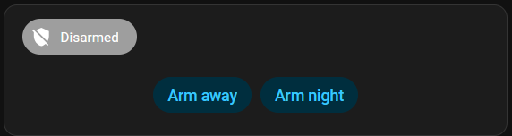

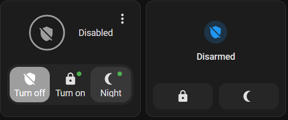

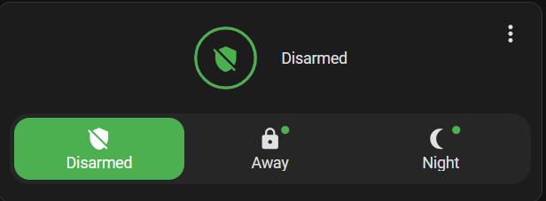

Hi, there are quite a lot of options.
These are a few of my attempts and the first is the one I use:
Thanks Nick, that is exactly the kind of answer I was hoping for, because your three attempts settle something for me.
Between the alarmo-card with the keypad hidden, your chip and buttons version, and the native tile card with the alarm modes feature in the third screenshot, the compact form is clearly already solved, three different ways. So “make it compact” is not the gap I thought it was, and I would rather find that out now than after writing a card.

Hi, this is the YAML code so you also see the card that is used:
type: custom:alarmo-card
entity: alarm_control_panel.alarmzonehall
keep_keypad_visible: false
button_scale_actions: 1
button_scale_keypad: 1
states:
  disarmed:
    color: green
  armed_home:
    hide: true
    color: green
  armed_night:
    color: blue
  armed_away:
    color: red
show_messages: true
show_ready_indicator: true
show_bypassed_sensors: true
use_code_dialog: false
hide_keypad: false
use_clear_icon: false
Thank you Nick. Looks like the alarmo card needs the alarmo integration to work. Unfortunately I have Ring.
