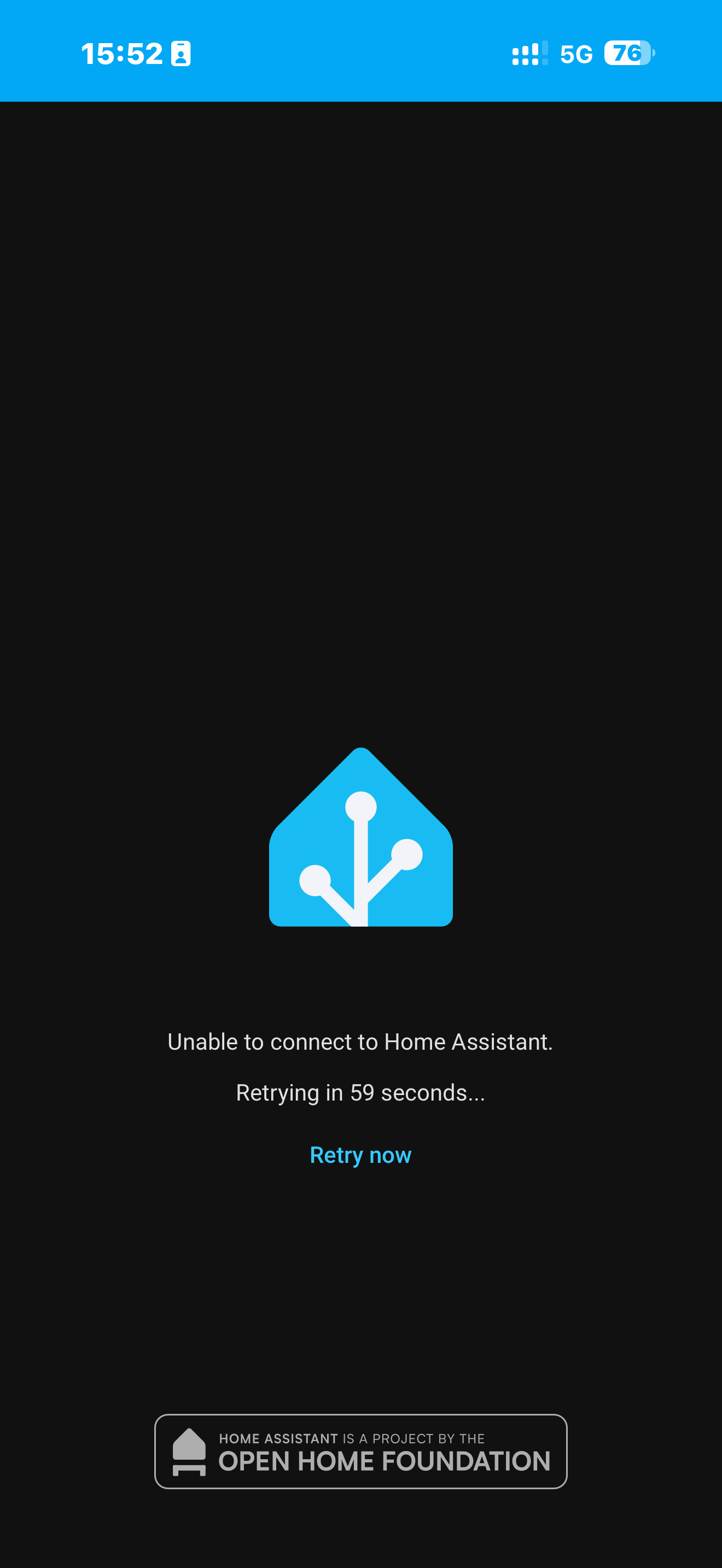

I recently set up remote access to my Home Assistant instance using a Cloudflare Tunnel, and it’s working fine overall. I can access it externally from any web browser — Safari, Chrome, no issues — and it also works fine when I open it in a mobile browser.
The problem is with the Home Assistant Companion App. When I try to use it, I get stuck in a permanent login loop, and I’m also not able to change/edit the server URL within the app.
Interestingly, when I try this on a different iPhone, it works without any issues. It’s only my personal iPhone that has this problem.
Things I’ve already tried:
  • Clearing the iPhone’s cache
  • Uninstalling and reinstalling the Companion App
Nothing has worked so far. I’m honestly out of ideas at this point — is there some kind of local config/cache file I need to reset or delete? I just don’t know how to force the app to regenerate that.
Since it works fine on another iPhone with the same network and same Home Assistant setup, it really seems like it must be something specific to my device.
I’ve attached a screenshot for reference. Would really appreciate any help — thanks a lot in advance!
